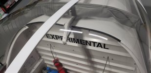

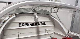

This may be old news to the "original" RV-6 folks, but might be of general interest to others. My RV-6A (slider canopy) has always been a little bit “drafty.” Based on anecdotal conversations and forum discussions, my guess is that the level of draftiness is more or less typical (and I’m too lazy/not interested in adding things like aileron boots, etc. that can help).
For reasons I will not bore you with, I recently added a modest bit of simple “Edge Trim Black Small, Fits Edge 1/16 to 1/8 Inch” rubber welt to the edge of the sheet metal where the top of the fuselage/turtledeck skin ends and gets covered by the backside of the fiberglass slider canopy skirt when the canopy is closed. [IOW more or less on top of the baggage compartment bulkhead.] Attached snips provide a visual.
Turns out this little bit of rubber welt has made a major reduction in the level of draftiness. Who knew?! Apparently, much of the draft was coming in via this top of fuselage/sliding canopy. Still a little bit of draftiness going on, of course, as an RV-6A is not exactly an F-16, but this is right up there with the best $11 spent to-date in my aviation ownership experience.

It just slides on and sort of grabs to the sheet metal; moving it around a few times does not seem to mess up the grab all that much.
[Note: I originally put the welt over the entire "perimeter" of the turtledeck sheet metal but this made the fit **way** too tight when the canopy was latched.] PM me if you want the exact welt used (don't want to get in the way of Doug's advertising rules).

I don’t see any of the rubber in the pics
