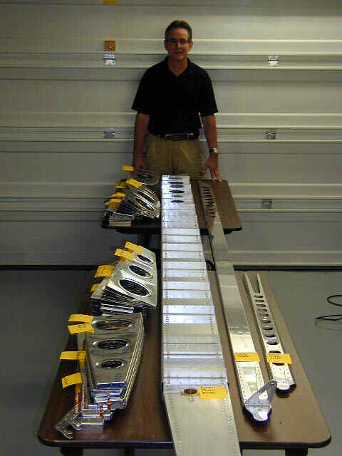

Wing Progress Photo
I thought that it would be good to post a photo of my wing parts before I start assembling them. I am focusing on the right wing since my garage would be rather busy with left and right wings both. Since the ribs are labeled R and L, I thought at first the R were for the right wing and L for the left wing...WRONG! The right wing uses some of the R and some of the L parts. So, I trimmed, debured, and fluted all the ribs just to make it a little easier. That means the photo shows all of the right wing parts plus the ribs from the left wing.
The next step will be the riveting of the ribs to the main spar. Then the rear spar and stub spar (short spar in front) will be riveted. The actual riveting goes so quick. I have to be careful I don't blink :)

Here is my photo of the "pile of parts"

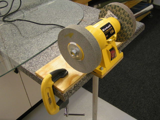

Also I have a YouTube video that shows how I fluted my ribs. I wanted a method that is easy, consistant and predictable. To watch, click on the following web address:
where did you get the knife sharpener, and secondly, I'm not sure I understand the function of the third wheel, which you flatened withe the bench grinder.
Steve,
I bought the knife sharpener many years ago, so I am not sure what store it was from. I have seen them since then, usually in stores that carry kitchen supplies. Maybe Walmart, KMart, etc....
The third wheel is a little confusing...don't feel bad. The problem is that since the second wheel overlaps the first just a tad, it would not be flat and parallel to the first disk if I just used two disks. The first disk would be flat on the metal plate, the second disk would be sitting at an angle, touching the metal plate and the first metal disk. So the purpose of the third disk is to prop up the second disk so that it is parallel with the first disk.
I cut on side of the third disk so it would not overlap the first disk.
Hope this helps,
Alan
Hi Alan- I now understand the use of the third wheel- its just a spacer. Thanks I have looked all over the place for one of those knife sharpeners- no luck. But I did find a couple of cheap can openers at Walmart that have a hardened cutting wheel. The wheels work just like the wheels from your knife sharpener. Thanks again for the idea. My wing kit inventory is now complete and I'm actually building an Rv-12 wing! This is more fun than a barrel of monkeys! Steve knife sharpener many years ago, so I am not sure what store it was from. I have seen them since then, usually in stores that carry kitchen supplies. Maybe Walmart, KMart, etc....

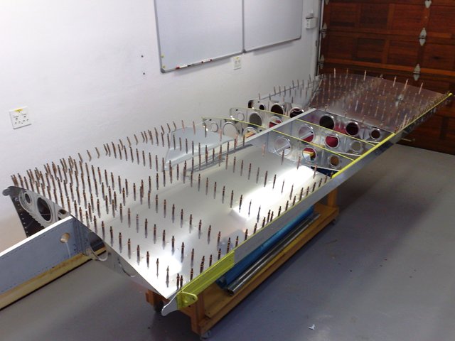

Well I finally finished my 12 wings! 7and 1/2 weeks and I'm not sure how many hours. It took me a little longer than I expected, but part of that was because my compressor crapped out on me and had to get repaired- luckily, it was still under warrenty. My overall impression of the kit was that it was very well engineered- the parts fit , I thought was fantastic. I can't wait until the fuselage kit arrives! Steve
I have # 74 and I finished my wings today. The kit is well designed and when you bring it all togather the fit is great. Now I am waiting for the fuselage.

Wing Kit arrives in Temora
Fellow RV-12 Builders,
After following ALL of your postings since April, I finally have something
to work on. The wing kit came yesterday. All parts are accounted for
and in perfect condition.
Thanks for paving the way with your generous input.
Cheers for now,
Sam
Temora Australia

Rudi's RV 12 Progress
48 Hours and started skinning the wings.
PS: More pictures on my website build log...
Regards
Rudi

WOW! Fast progress Rudi!
I think I've spent nearly that amount of time just trimming, deburring and finishing parts. Very little assembled yet. Makes me wonder if i'm doing a lot of unneccessary work (even though I don't claim to be a speed demon) or maybe just making it harder than it should be. I've been trimming, deburring, using 3-M wheel, and ScotchBrite every edge on EVERY part.
What is your process for trimmning/smoothing the Wing Ribs, for example?
Thanks!
Dave.

Thanks Dave, I don't add the time studying plans, I do it during lunch at work or evening in bed, so time quoted is workshop time.
Every part is deburred, trimmed, and mating surface primed. Rib flange trimming with Snips, then on 6" Deburing Wheel, followed by 6" Polishing wheel all round both sides of edge. Then onto 2" Deburing wheel in Die Grinder for the rib lightning holes.
My 6" bench grinder with Deburing and Polishing wheels combined with 2" and 1" Deburing wheels in the Die Grinder wheel makes light work of most Deburing Tasks.
PS: Below is a picture of my bench grinder, when it was still new, get one with a very small narrow motor body, and try and fit it with as much as possible overhang, so that you easily maneuver parts while deburing around it.
Thanks Rudi! Appreciate the confirmation, sounds like were following the same "program" just like we were taught at Alexander. Appreciate the grinder overhang idea. That'll be my next workbench project while I wait for my little compressor to come back up to pressure. Hoping Santa will have a BIG one in his bag!
