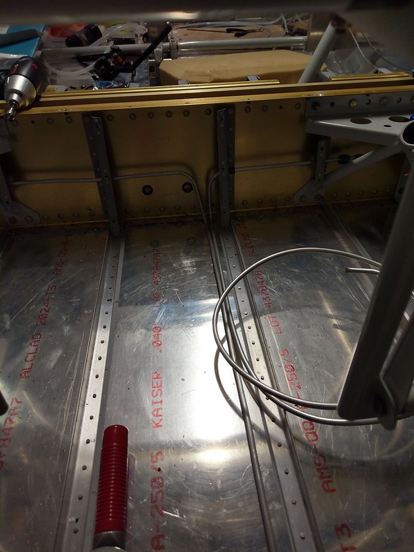

I got back in the garage for a short time today. It was cold. I managed to stuff myself back in the bad boy to do the brake lines. Didn't finish, wanted to watch the Chargers a bit. Also, short a nut for the output bulkhead fitting. Have -6's but no -4's...bummer.
Been a while, see if I remember how to post pictures. Worked!

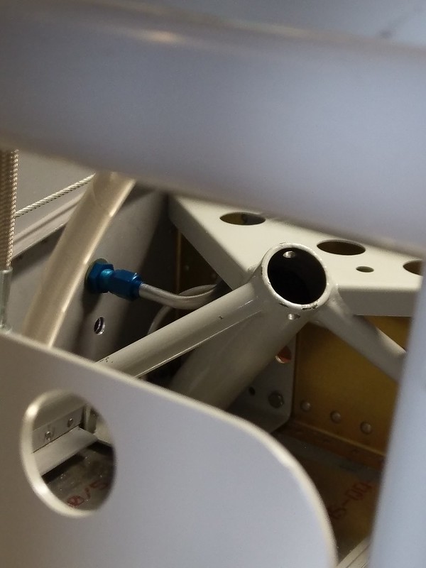

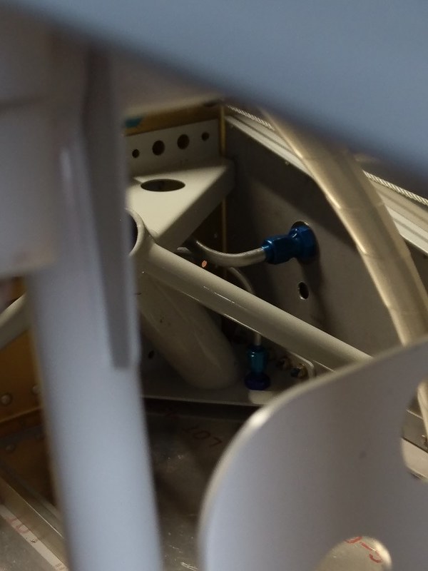

So I got the brakes lines installed and flared but not sure about the lower one might cut the flare off and shorten it a bit to get it parallel with the above line.
My inner "Monk" is screaming at me. I didn't notice it was not in harmony with the other line until I saw this pic. Will think about that...not that the top line is perpendicular to the bottom skin anyway..
Also wasn't sure I stayed within the confines of the outlet passage on the cover sheet metal. I checked Bruce Swayzes' page and I think I might be OK.

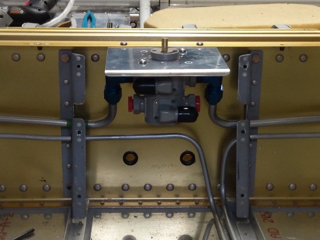

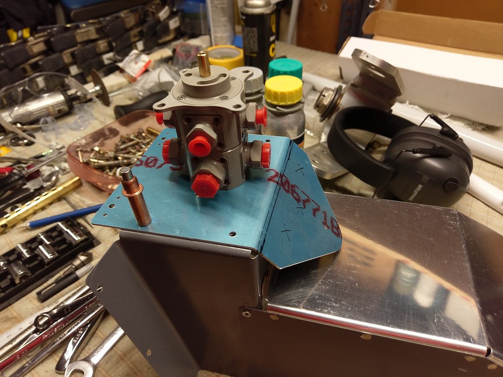

I am diving into the duplex Andair valve today if I can skirt around my Julianne's to do list a little...haha
Did some study of this task and I believe Tom@TSflightlines is the best bet for the plumbing. Still going to futz around a bit with it.

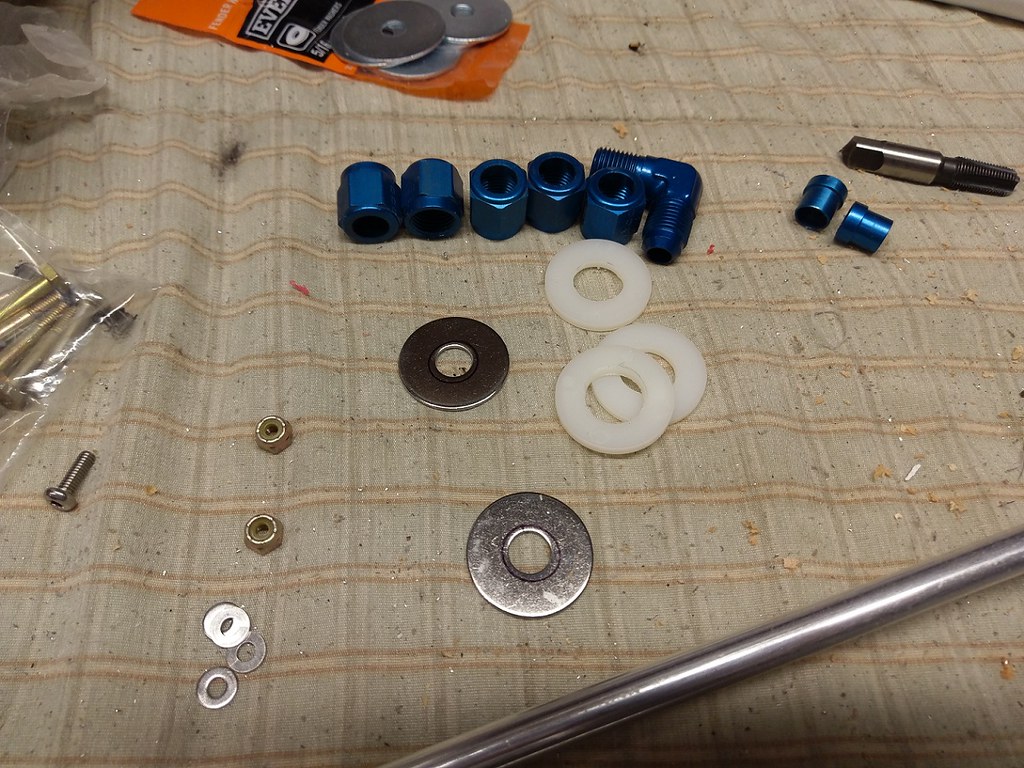

Andair valve -4 fuel inlet
I just realized my valve has -4 or 1/8NPT fittings for the fuel inlet, I believe I need -6 for the inlet.
Crud! How long will it take to get the correct fittings from Andair? bummer...

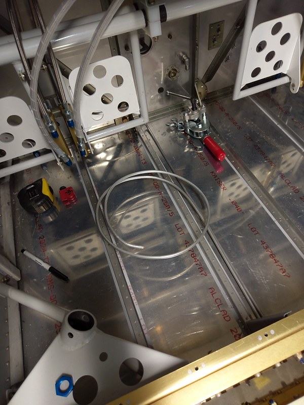

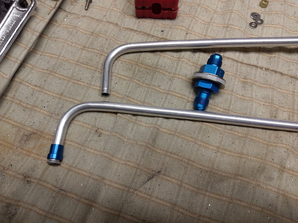

Fuel lines

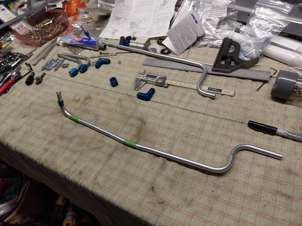

Got back to the fuel lines, need a return so I spent a lot of time researching
the best way to do it. At least I think it is currently.

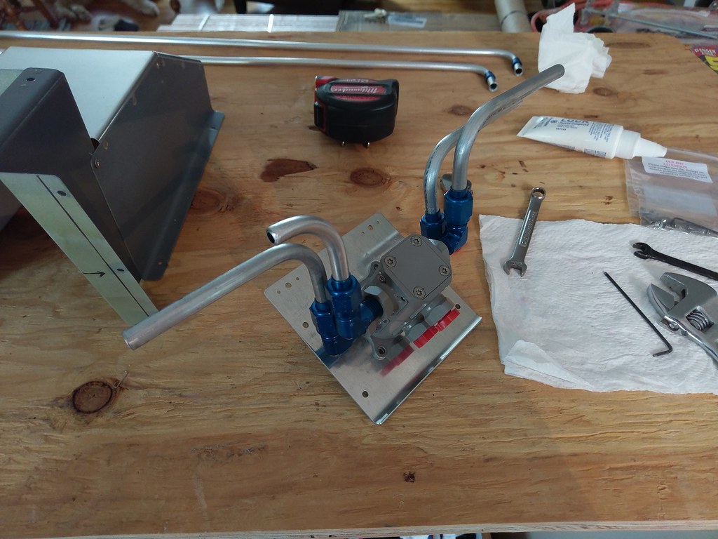

Start of fuel mockup on the bench. Kitchen remodel bench.
I looked at the standard Vans valve and it had 90? bends.
Now I worked for a time in fluids and controls at an engineering firm dealing with prototypes and we avoided 90? bends like the plague in pneumatic systems. Low pressure systems, 50-250psi. I am going to have to do some semi-scientific empirical testing on this to satisfy myself this is GTG as I don't have four different types of engineers to get free information from hahaha!
Good news is I can read!
Kentlik.
You have seen the stock RV-7 boost pump, check valve, filter contraption with all the plumbing? Looks like a thermal detonator. Lots of bends, and seems to work just fine.
Bend on.
(oh, dont forget to add the sleeve before you flare the end. Ask me how many time I know.)
Does take quite a bit of thought to get all of that stuff under the stock covers, ESPECIALLY with the NPT ports. Our way might not be the least expensive, but certainly the least headaches. BUNCHES of them flying without issue.
Bend on.

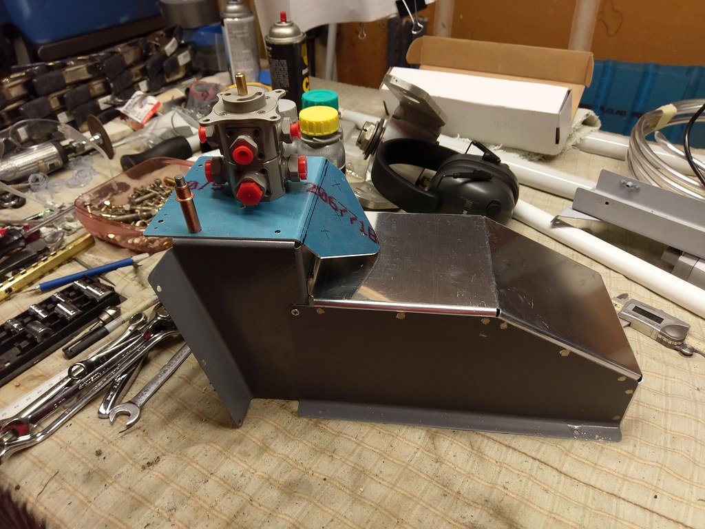

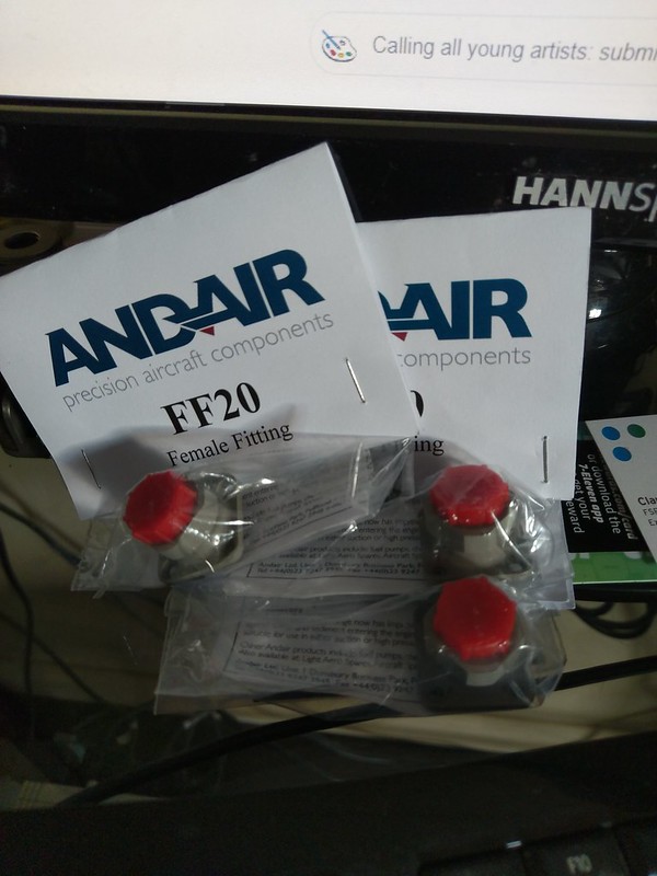

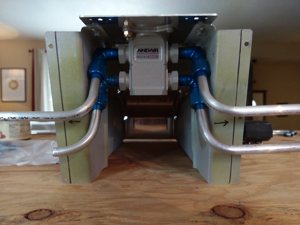

90? Andair fittings
I ordered a few of these fittings from Andair to use in the fuel system design.

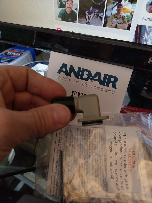

Wire
So, I received some of this stuff today. Doesn't look like much but my understanding is getting all this stuff in in the correct orientation is a bit of a job.
We shall see...

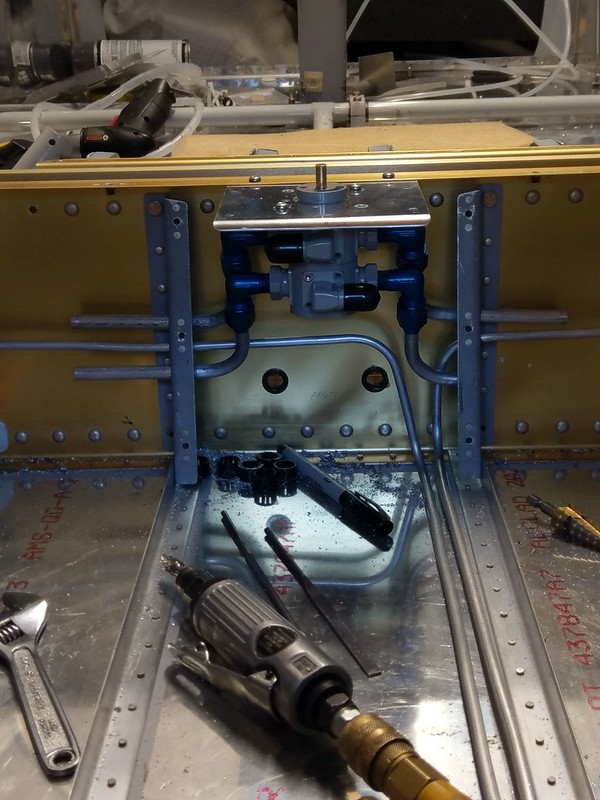

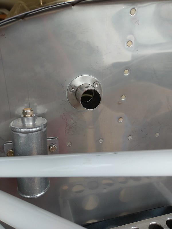

Fuel valve plumbing coming together. Not terrible but does make me a bit heavy headed leaning over for so long. Oh well.
Kent, good call on that carbide bit in that die grinder eh? Love that thing, it's a beast!

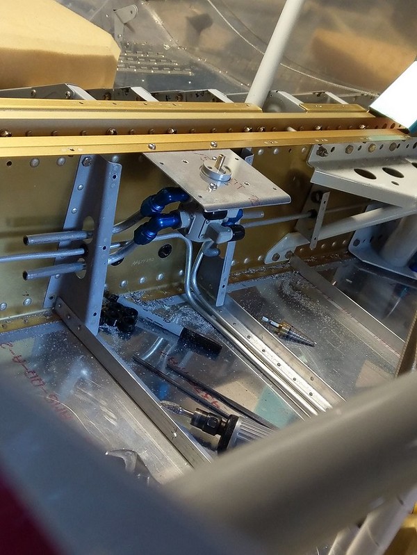

I took some time to do a few little tasks and then deal with more fuel line math...
Added one more of these electrical firewall access'.

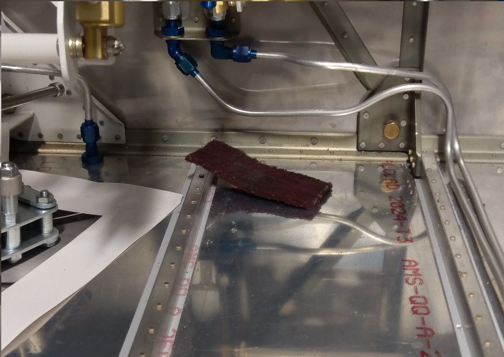

Fuel line
Two supply lines in, finally
I am going repaint the cover plate attach points and "flemish" them up a bit.
Now to the return lines

I am with you on this one! I am done with the darn fuel lines...almost. Missing one 819-6D fuel line sleeve! Can't believe it...all the same I am moving on to repair of large cut-outs in the first bulkhead behind the avionics panel then adding the hinges to the lower portions of the firewall etc...

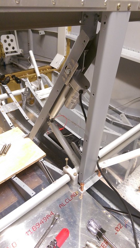

Working on a new flap actuator tunnel. I wanted to get it set up with my new linear actuator. I had one in 5" but it was not smart so I ordered a smarter one and need to change the mount location. Also, need to turn a headpiece on the lathe which won't take but a minute.
[/url]IMAG0681 by Kent Luttrell, on Flickr[/IMG]
[/url]IMAG0680 by Kent Luttrell, on Flickr[/IMG]
Did some tests with the old tunnel and believe I have a good plan.
Finally worked out the math on the new flap actuator. Or at least it works on the bench but we will see how she performs in the plane...
Had to make a new rod tip to thread in the Heim joint
