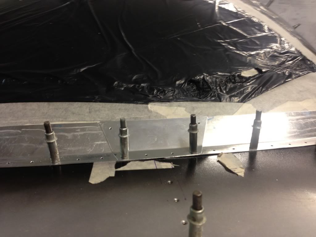

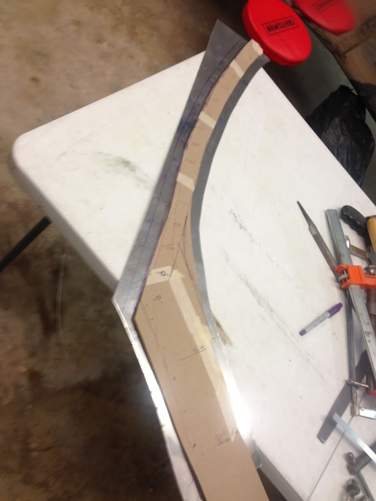

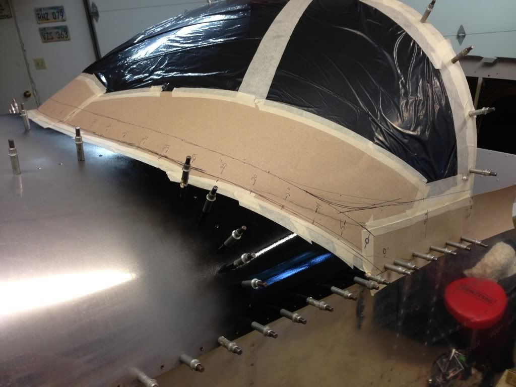

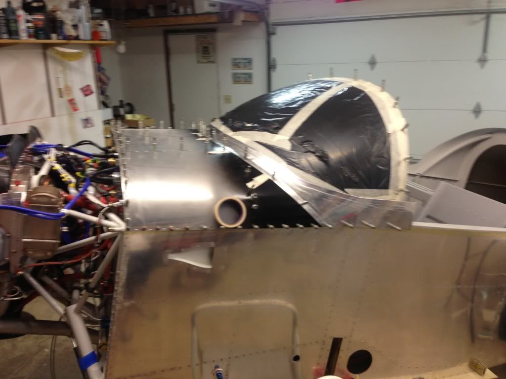

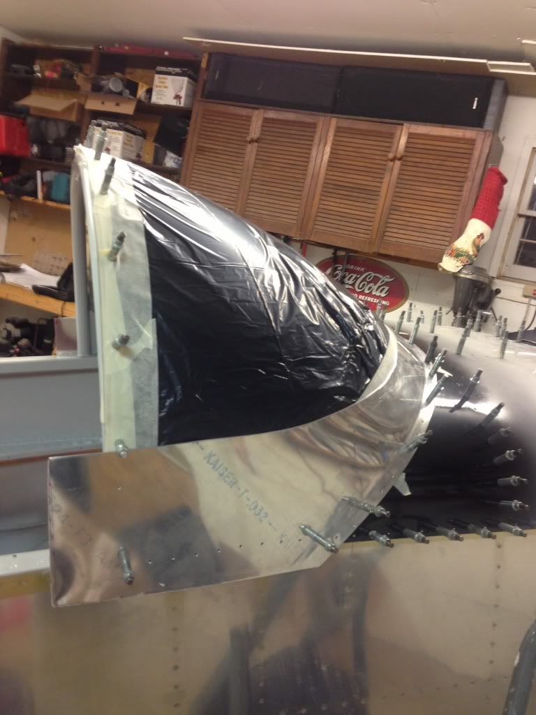

I used some cardboard scraps and paint stir sticks to position some flanges on the duct, I used the DanH fiberglass method of wetting the glass between 2 sheets of plastic and squeegee'ing out the extra. I did slightly wet the surface of the duct wth epoxy before putting the glass on.
Kinda hard to position the duct so gravity helped hold both flanges on at the same time, I plan on doubling up the flanges from the opposite side once the first side is cured so it has glass from 2 directions holding it to the duct.

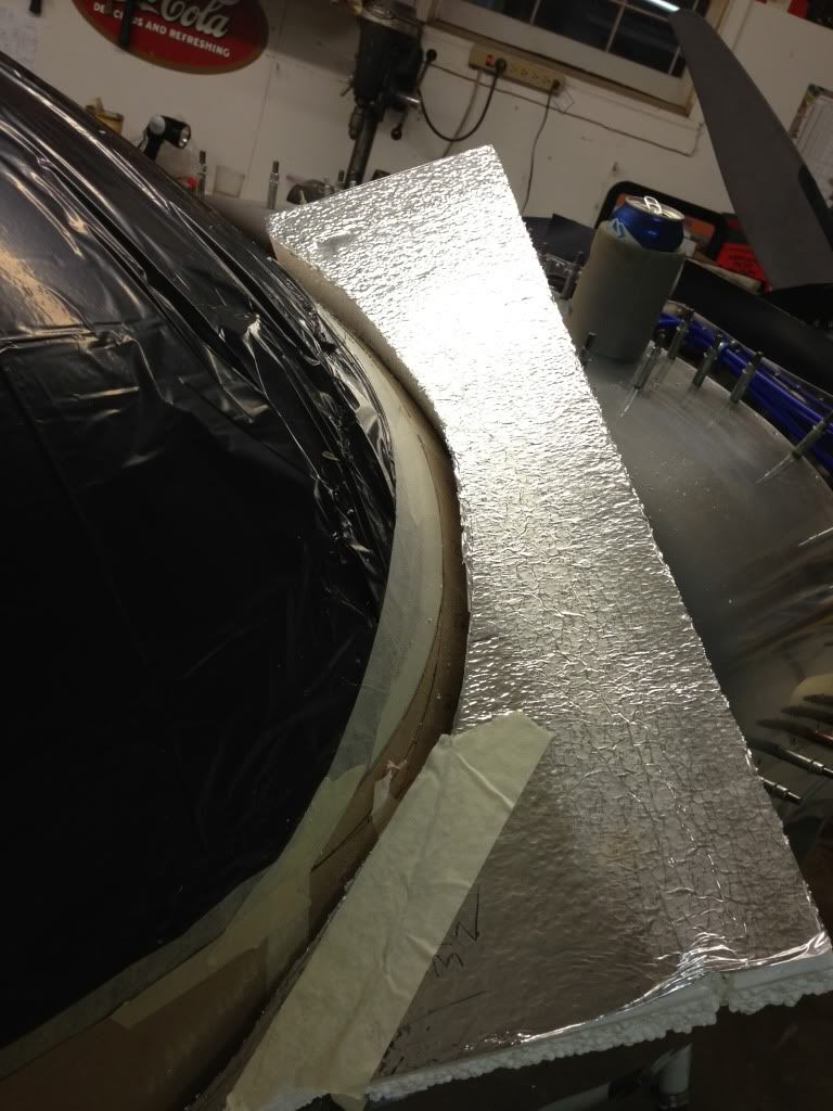

With the lower duct and cooler clamped in place I found it easiest to cut the individual piece of foam to fit and them glue them together with epoxy/micro.
The foam sanded to shape, I tried to expand everthing aft of the opening. It does get tight and small around the engine mount.
4-5 layers of filler sanded down to make a smooth surface, ready to check the fit again.

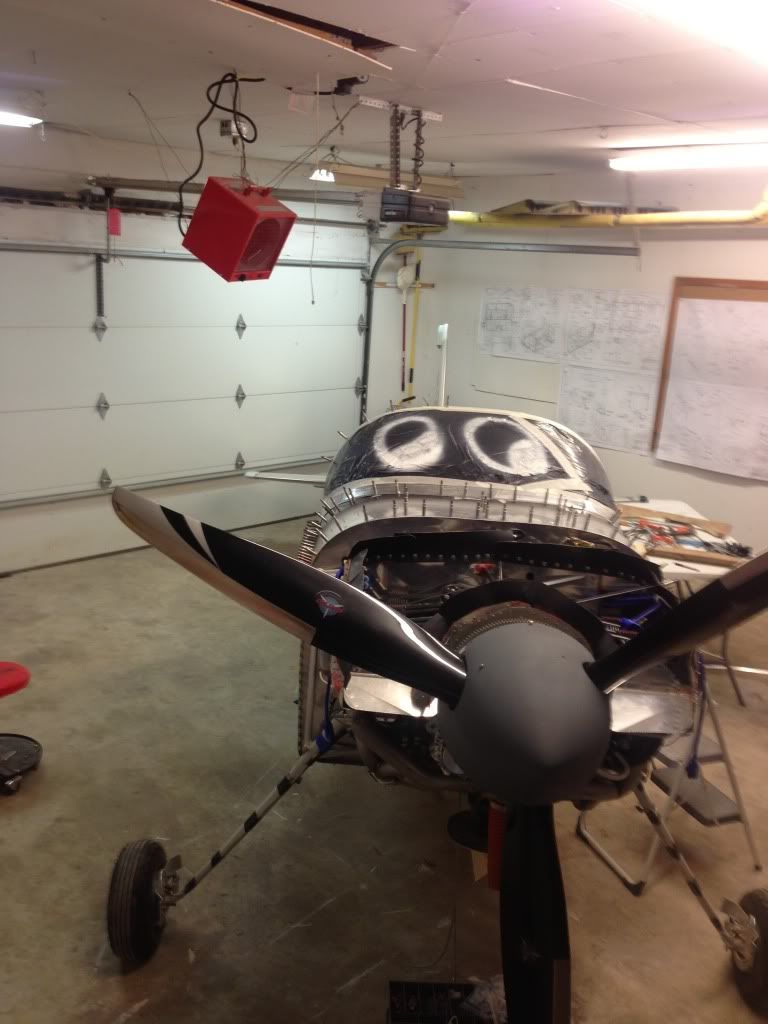

I installed the rear baffling piece and RTV'd the Oil Cooler Boot to the baffling. The extra bracing around the oil cooler junction left the ol' center case to baffling angle brace unneeded so I removed it. Ultra Black RTV seems to stick to the urethane rubber pretty well and it's a little more flexible than the ureathane specific glue smooth on sells. I also had to re-route the spark plug wires.
I used some packing tape over the oil cooler to provide a slick release surface, and RTV'd a Ultra Black gasket onto the fiberglass duct. It's much easier to make this gasket stuck to 1 part now for future disassembly. With a little more time and clean-up I hope to be test flying within a week and a half.
I finally assembled it all....
Of course it shifted just enough from fabrication to assembly to hit the cowl.

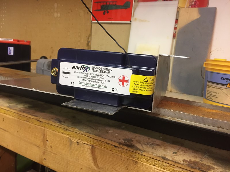

So I did some reading and bought an ETX680 EarthX Battery, why buy their pre-made battery box when I can make one for $4/hour minus materials I already have....

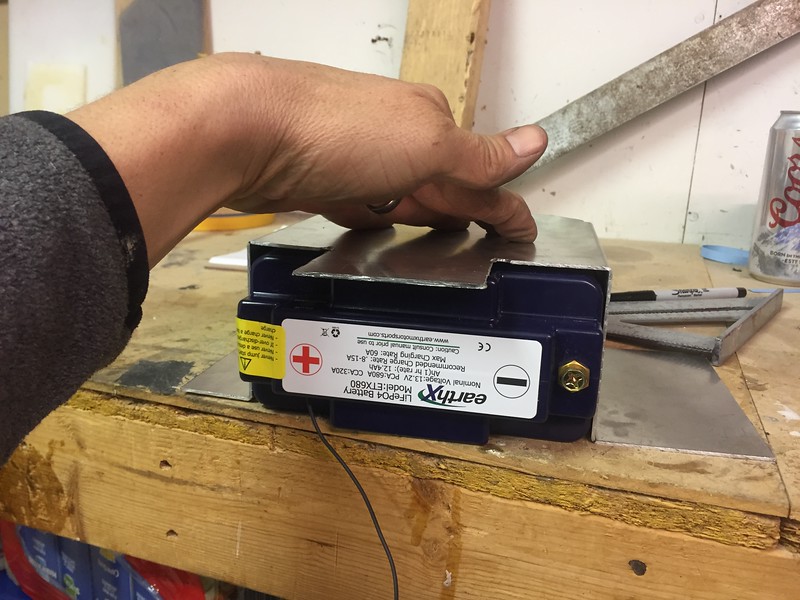

I recieved the EarthX in the mail today, really is hard to believe the weight difference with it and the PC680 in the other hand.

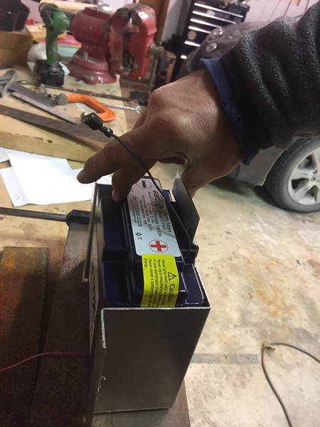

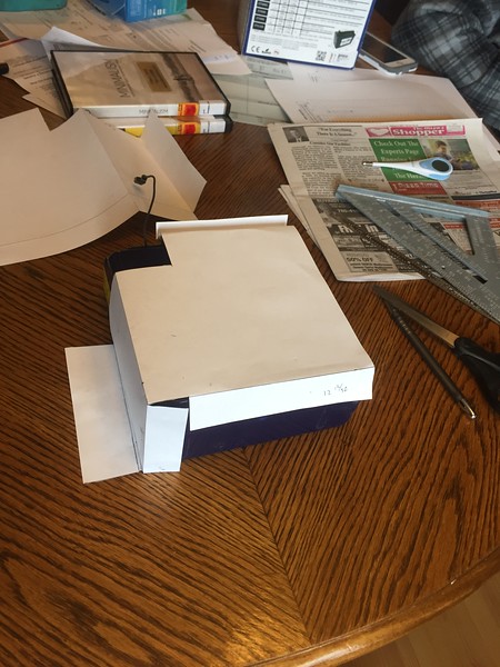

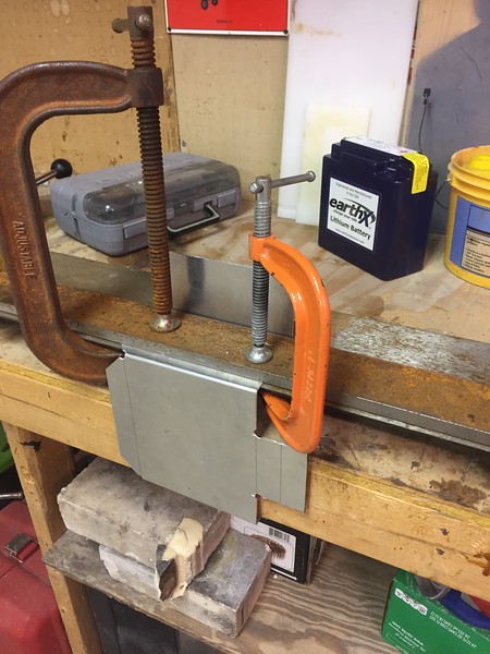

I made a paper pattern to hopefully figure out any mistakes first, it was also way warmer in the kitchen than the garage.

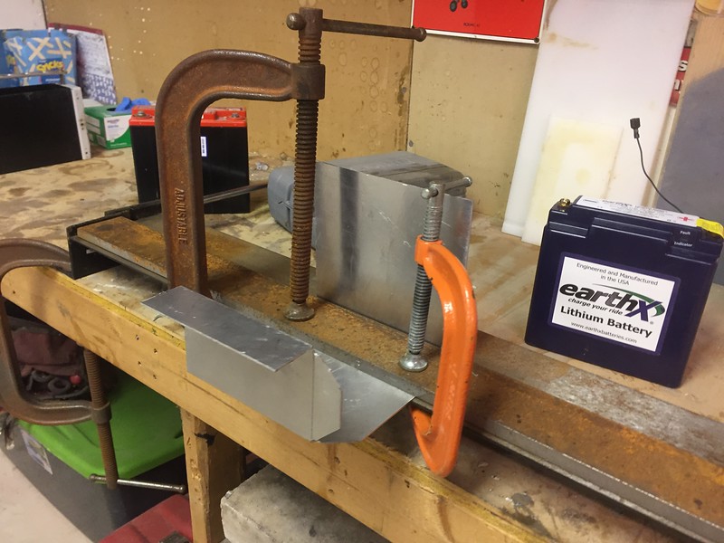

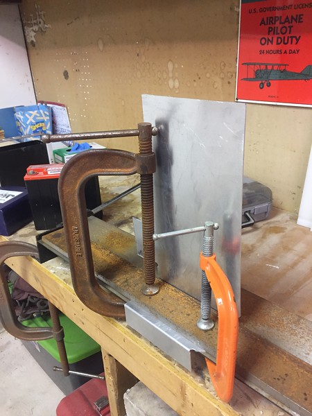

Cut some .063 oversize and started bending things with my el' cheapo brake...

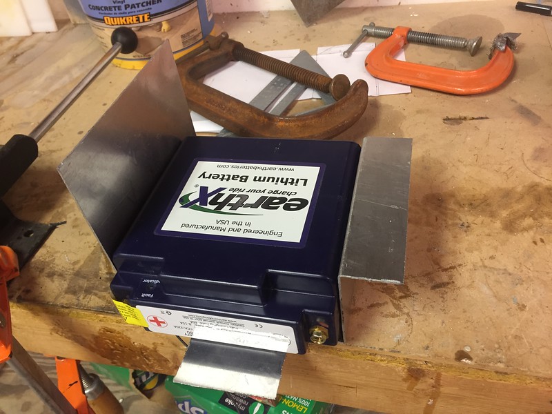

Checking the fit on the battery, the bend radius can vary and change dimensions a lot if you're not careful.

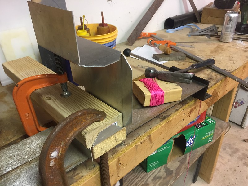

More Bending and Fitting....

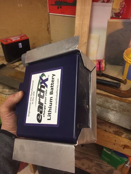

I used 2X4's along with a scrap chunk of 2X4 and a hammer to bend the smaller lower flanges, I pre-plan the bending as much as possible but on multiple bends you usually have to compromise.
By bending the side flanges first I was able to use the brake to bend the longer lower flange.

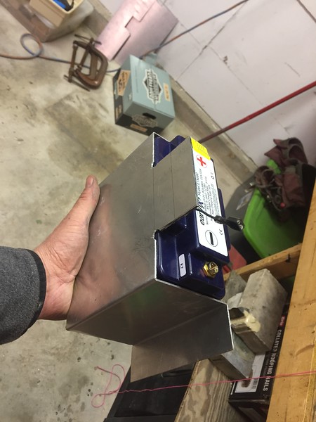

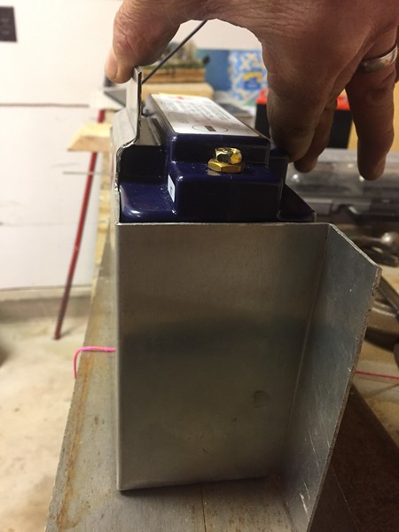

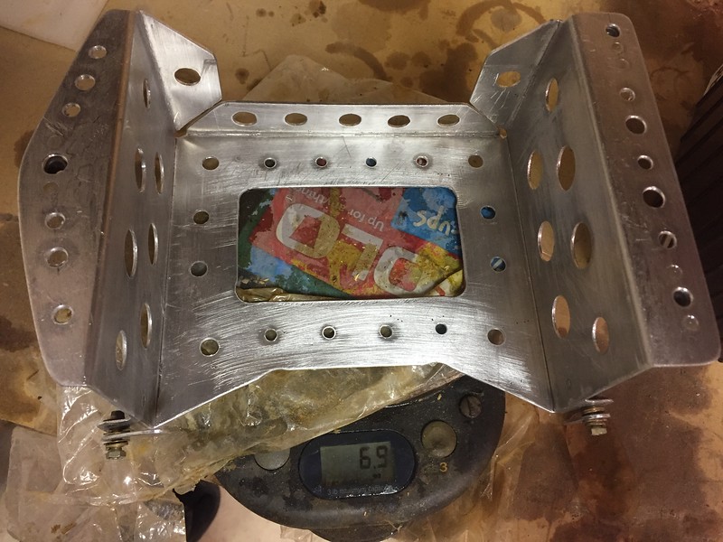

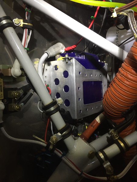

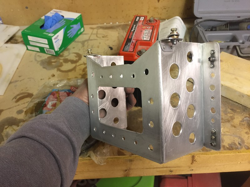

I really liked the idea of no hardware to loosen/tighten/loose in the lower cowl to bolt the battery in place so I'm trying to copy the retention flange EarthX has on their battery boxes.
The bendable retention flange wasn't so bendable, I ended up using a couple small angles on the side of the box and little tabs as hold downs. After lots of holes it weighed 6.9 oz , I'm curious if the one EarthX sells is .032 material.

I also received a pm about adding a heat shield on the bottom to prevent heat from the exhaust warping the bottom of the battery.

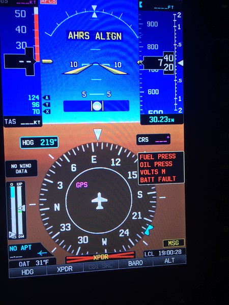

Hi Kathy, I believe I just spoke to you on the phone about chargers for my EarthX. Thanks for answering all my questions!
I understand the battery is designed to provide power as rated after an Overvoltage event, it is a new system added to the airplane and thinking through Murphy?s law. I also have thought through the same senario with my lead acid battery. I really can?t wait to hit the starter button with my new EarthX!
Hooking up the EarthX fault wire couldn't have been easier thanks to their excellent manual. 1 wire to a discreet input into the G3X, I temporarily grounded the wire to test the annunciation as it doesn't display if there isn't a fault. Note the red "BATT FAULT" in addition to other alarms on the PFD:
Bend Raidus
Just looking at the bend radius looks a little tight, don't have my old books but thought it was 3 times the thickness of the metal. Also edge of the metal looks rough which can cause a crack at the bend. Just a thought.
