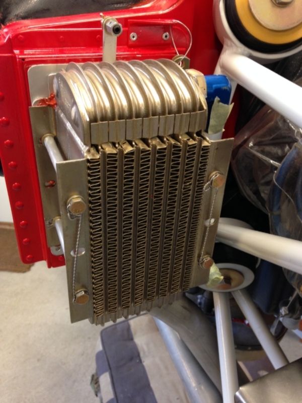

Thanks, yes the oil cooler shutter will come in handy with the Gothic weather:D
Tanks were built and tested leak free by previous owner, but better safe than sorry I guess. And much easier fixing a leak before paint if needed. Also like to have auxilliarys stay where intended, maybe overkill to safe wire the cooler but it feels comforting when airborne:)
