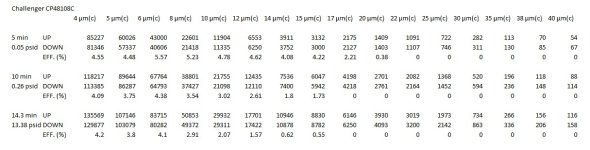

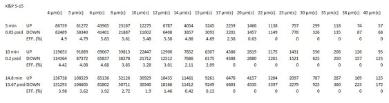

@DanH does this data infer that the media in the Challenger has larger holes than the Champion and it isn't until some of the larger particles start to choke those holes that the Challenger filter starts to increase efficiency?
No. Here are the particle counts for the entire test...which does not last long. Data is usually recorded every 10 minutes, but the tech terminated this run when the deltaP rise (lower left) indicated it would not make it to 20 minutes without bypass opening.
Your assumption about dirt loading causing an efficiency increase is common. I too found it surprising, and asked the lab director about it. With a constant displacement system, rising deltaP forces more trash through whatever openings remain available. One theory says there is probably some filter media distortion also, releasing trash.
The numbers don't lie. It's a truly terrible filter.
Interesting to compare the Challenger and the S-15. Challenger claims 22 µm filtration for their "aircraft filter", but there is little performance difference.

Today's Wow Moment.
Filters arrived back from the lab, so I cut them open.
Champion:
Tempest:
Wix
They all look new, right? Nope. The Champion stopped 25.6 grams of dirt. The Tempest stopped 17.9 grams. The Wix stopped 22.4 grams. There was dirt in the cans, and in the remaining oil, but the elements themselves, although loaded with so much dirt that deltaP had gone to 10 psi, looked perfectly clean.

This is interesting. The picture of the Challenger element looks *exactly* like the K&P S15; I thought they were different (i.e. Kitplanes, 10-15-2022, "A Permanent Solution" - Paul Dye, ref. "Challenger told us that their filters are manufactured to their specifications (by K&P) with a screen rating of 22 microns.")
I wonder if they allowed their specification to drift, or it was B.S. all along? I know that the screen for the FLO PCS4 is much larger than the S15, that was evident when I did a side/side comparison of the two a while back. (attached)
A moot point -- going to throw them both in the trash.
B
Go back a few posts and compare the performance, S-15 vs Challenger.
Both are sub-par performers. Even so, I would have expected the Challenger to perform *much* better than the S15 given the claimed sizes (22uM vs 35uM); some 37% better...

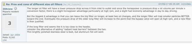

From the WIX website there are three variations on the 51515 cellulose media in different lengths. The 51515XP is a synthetic media.
51515 - 5.197”
51068 - 4.338”
51521 - 3.790”
The specs on theses three should be the same; however, the shorter versions have a better chance of needing to bypass a clogged media and the 51515XP is a different media.
This is from a MOPAR Forum.

Heather Rocco
CEO/Co-Owner
Challenger Aviation Products, Inc.
Internally at the factory, the Challenger filters were evaluated to determine suitability for operation in our test cells to reduce waste since they are reuseable. During this evaluation it was found that the Challenger filters did not filter down to the particulate level that a Champion or Tempest filter will however, it did perform better than a pressure screen for particulate removal. Based on these findings if the Challenger filter is installed, I recommend performing oil changes earlier than the 50 hours recommended by SB480F for spin on type filters.
Lycoming's "it's better than a pressure screen" statement pretty much confirms for me that the thresholds of FAR compliance were low in the original STC.
ds
And from his communication with Challenger -
Thank you for reaching out to Challenger Aviation.
After reviewing the information presented, it appears this unauthorized test has no verifiable information. There is no lab name listed, no testing variables nor are there parameters of how these results were determined. From what we can see, there is a partial summary of a full report that will not be released. Therefore, Challenger will not be making a statement regarding the test referenced.
Our Challenger Aviation Products, FAA/PMA certified filter went through rigorous testing upon receiving our STC approval. As we are sure you are aware, that information is proprietary per the FAA requirements. However, if you would like to see what type of data is collected for that certification process you can find it at the following link.
Our certified aviation oil filter has been flying since 2006, with only minor changes made in 2009. We have had wonderful feedback from the pilots in the field flying our certified aviation oil filters.
As far as the non certified aviation oil filters being referenced, we have no response as we do not promote nor encourage the use of non aviation certified filters for use in any aircraft, certified or experimental. The K&P S15 oil filter is not certified for use in any aviation applications.
Thank you again for your inquiry.
Heather Rocco
CEO/Co-Owner
"Unauthorized test"? What would the response be to UL testing? Could go further point-by-point but why bother. Choice of such defensive defensive wording says a lot, at least to me.
Ahhh - so you wish to denigrate the testing that was performed outside of your "authorized" control, but you also will not release the testing results of your own.
Got it.
I call BS.
Heather Rocco
CEO/Co-Owner
Defensive and data free -- this reads like a CEO in denial about their companies future.
Me thinks they won't be selling their OEM'd "filters" much longer. Maybe T-shirts and other "Merch" tho...
