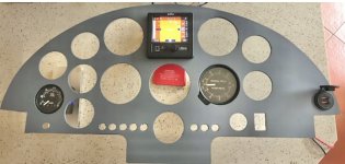

still work in progress what do you think
I am trying to get some more leg room, a Garmin 660 , an MGL ems2 and MGL FF as well as the av30, so the panel is angled in but, I still have to figure out the top lid support in front of the canopy
