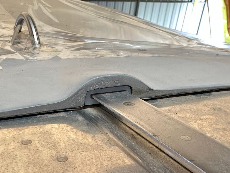

Here's a picture of mine when I was working on the skirts. Fiberglass skirt, but the same idea as the aluminum doghouse. I'm still under construction and don't have a lanyard installed yet but without it, when I open the canopy, it pushes that block aft on the slider track where it would just stay forever because there's nothing to pull its back forward when you close the canopy.
The lanyard is just a piece of fishing line/fine wire/whatever works with one end attach to the block and the other end attached to the canopy frame to pull it back forward with the canopy.

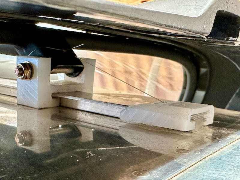

I have some pictures of my installation here. I recall it took several tries to get the lanyard to be just the right length, but it actually works pretty well with my molded fiberglass rear skirts. One piece of advice, it's easier to install from outside the fuselage - tie one end to the slider block, then reach up and thread the other end around the attachment for the C-661 slide block. (Edit: I recall I used a slip knot somewhere in there to make it less difficult to tie)
