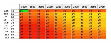

The system I've been flying since early 2016 is dual map. It also allows setting any advance schedule desired at 100 points.
With dual maps, I keep one set for 23 fixed (angle valve 390), and the other holds a schedule with advance based on MP and RPM. The current schedule is below. I can change back and forth in flight with the flick of a switch, which makes comparison easy.
For sure, the angle valve doesn't want as much advance as the parallel valve engines.

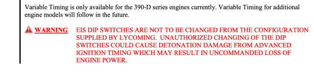

OSH2019 Lycoming announced that they will be white labeling the SureFly ignition, changed colors :) and called it a Lycoming Electronic Ignition System (EIS).
Check out Lycoming Service Instruction No. 1443R.
Lenny, I have that one, formerly published on the company website. Is it still there and I've missed it?

First, if I didn't want people messing with the settings I'd just disable the DIP switches in software and wouldn't just warn them not to mess with it or their engine will blow up.
Second, it wouldn't make a lot of financial sense for them to write their own code in-house and then certify it, when the hardware & software they are getting from SureFly is already certified. That involves thousands of hours of development and testing.

And a relevant datapoint - during my SDS testing on 91E10 fuel I found my limit at 31 degrees at 16/17k altitude when WOTLOP. 100LL would obviously tolerate a fair bit more timing. I have my limit set at 29 now.
What does your testing show on your AV 390 Dan? Curious.
I rarely pull mixture much past peak in cross country cruise, as I am not willing to accept the speed loss.
Here's an example, playing around with advance while returning from OSH 2019. I'm at peak EGT or a little leaner, right where speed starts to slip. Left photo is about 28 degrees; note MP/RPM and see the schedule a few posts back. Right photo is 23 degrees, re-stabilized about 30 minutes later.
You've seen the combustion speed charts. If I pull leaner, both speeds drop off, but the 28 degree speed will probably match the 23 degree speed, and fuel burn will drop a little. Pull a lot leaner, go a lot slower, burn even less fuel, and the advanced timing would probably be superior. That's the obvious route to flight duration, but this setup is already giving an honest four hours with reserve.

It appears from this Lycoming document that all approved timing with their EI is fixed- no additional MAP advance. Is that how you read this too Dan?
Currently only one model has an approved variable timing part number, the IO-390D, in four configurations. Don't know if any customers are using the variable option in the field. Maybe CubCrafters with their "CC393i", which is a D3B6. I was researching 390 variants for an upcoming article, but we ran out of space, so I stopped.
The application document is SI 1443R. It is titled as a app doc for Slick mags, but includes all the EIS approvals.
Looks like they are performing testing to determine safe mapping- good idea. Get the product out on the market with fixed timing now and users can hopefully update to variable timing when the data is in.
