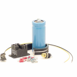

B&C has this device in their installation kit for permanent magnet backup alternators, you might see if you can talk them out of one. :)
https://bandc.com/product/pm-ov-filter-and-ov-protection-kit-14v-2/

Sadly the French connection only ships to the EU. I looked at the BandC overvoltage kit but its only rated to 15 AMPs. I am not that much of an electrical junky just tired of giving my money to PlanePower.
