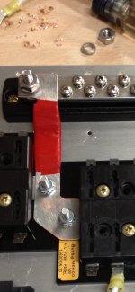

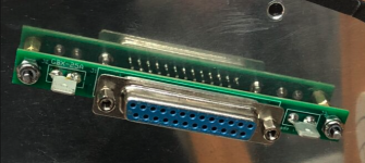

You can make more busses for the grounds this way. Out of the aeroconnection book.

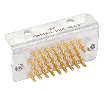

D-Sub connectors are good for 5A. I like using these, the ground block is physically strong, the pins are rated for 15A, they are gold plated for long life and reliable connections. And the mounting connector screws on.
They are expensive, but if you shop around you can get these for a reasonable price. And you must get a DMC AF8 crimper with the right positioner.
