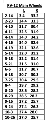

My experience with a TPMS on the mains (sensor is too big for nose wheel clearance) is it was novel to begin with, but not much use if you know/assume the leakage rate and just accept adding air every 4 or 5 months. I have wheel pants installed and at some point you get used to what the tire sidewall should look like (and they should both look the same on preflight). I have had one flat and that was because the o-ring in the TPMS sensor was damaged and the air leaked out after I added air to the tire. The other problem is the display battery does not last long and the solar cell charger does not work in a dark hangar, so one more thing to run a USB power cable to.
If you do add one, be sure to add a counterweight on the opposite side of the valve stem to keep the wheel balanced.
