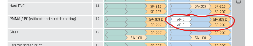

I hate to rehash this, but I've been reviewing the Sika USA website and reading up on 295UV. SIKA publishes a pre-treatment chart (attached) that doesn't show an "activator" use for PMMA (which is what I think our canopies are made of) for the 209D that everyone is using.
Has anyone talked to a Sika rep to get clarification on using the activator?
The green left column is for small items, the blue right column is for large items with flex.
And, the first row is preferred, second alternative.
AP-C stands for fine abrasive pad.
JZ
