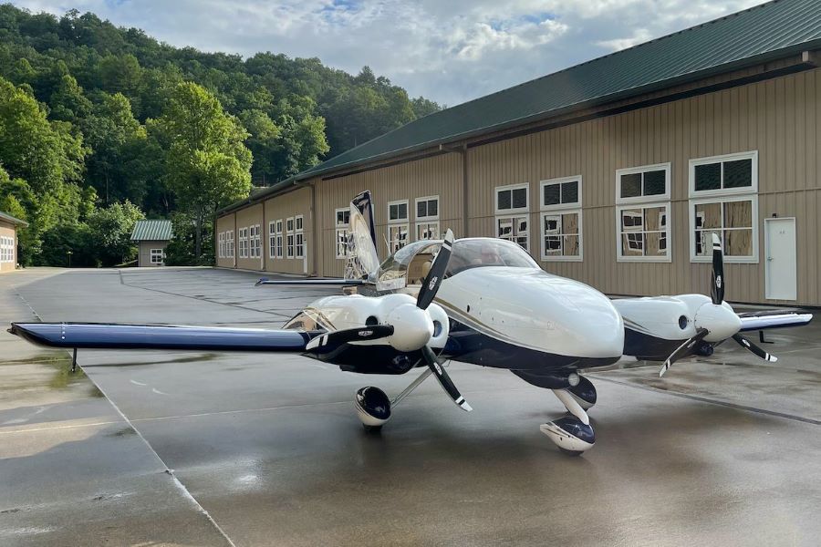

  • Twin engine UL 520iS or 520T Velocity N106VT went down last year after Oshkosh 1 Aug 2023, layover in GA on way to Florida, crashed on T/O.
