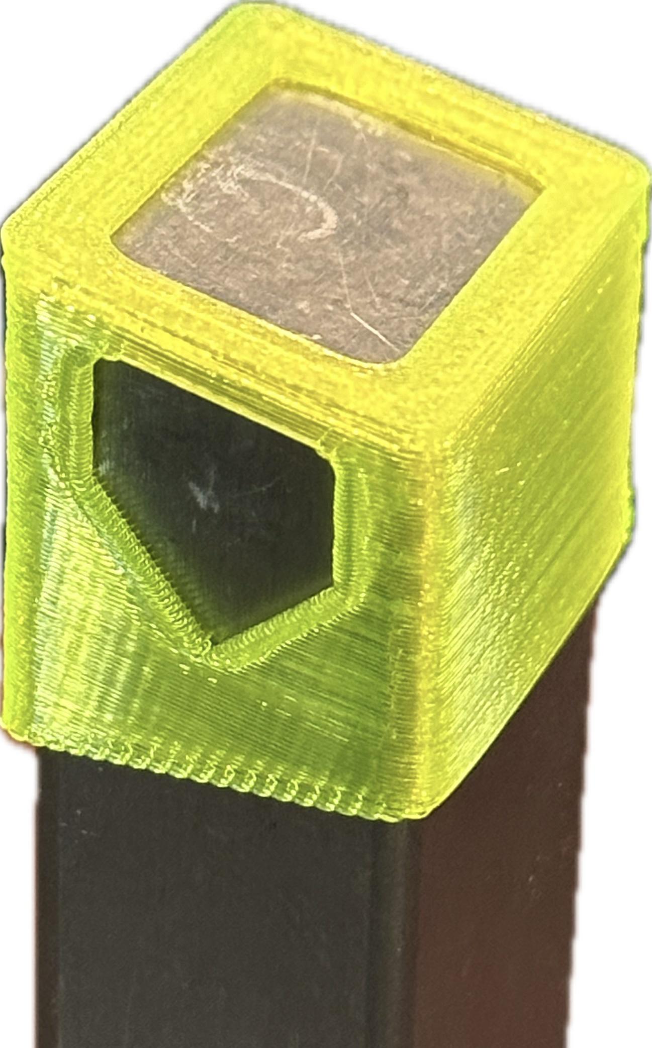

The most common Tungsten Bar in the US is the Aircraft Tool Supply ATS 6007. This is the 1x4x5/8 bar with an angled face that is included in most RV kits and can be used to hit 95% of the rivets in the kit. Cleveland modifies this bar by cutting the angle on the long end. It can be purchased directly from Aircraft Tool Supply, ACS or many other suppliers. I made some bumpers for this that prevents dings and allows the bar to be positioned on the shop end blindly. I can look at a set of bottom skins and tell whether or not a bumper was used.

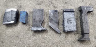

In the photo the bars are lined up with most used on the left. Here the first is 80%, the tungsten 15%, the “shoe” 3%, the funny looking thin bar (a fly market $1 special) perhaps 1% (but without it some rivets can’t be done), the last two are rarely used.
I find the tungsten bar ok and it is best choice for some rivets to, but the larger steel bar is, at least for me, easier to keep square on the rivet. It is especially good at riveting bottom wing skin as the side of the bar is the rivet surface (so the bar fit in your palm as you are doing the contortions to get your hand under the skin.
