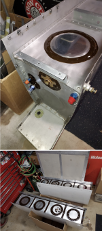

RE: Closed end pull rivet not so closed
I encapsulate with 1422A 1/2, every seam and rivet/screw. Here is a repair I did to a -10 tank, and a set of -4 tanks. You won't find an airliner that's made which isn't externally encapsulated as well. the "A" sealant is brushed on and flows out into every nook and cranny.
