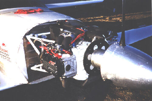

Below is a picture of the back side of the Marcotte direct drive housing. The friction disc has 16 rivet holes of approximately 5 to 6mm in diameter (hard to measure until I drill them out) which will be bolted to the flywheel face (so that the pressure plate etc. will not be required). I apologize about the quality of the photo, however you can also see the friction disc springs, which have a second black spring internal to the outer blue spring.
Tom.

The massive Marcotte bearing support case may be quite a lot heavier than necessary. The thrust and moments are not huge, unless you plan on really, really hard acro. You can easily quantify the prop moment:
M = I x Q x B
where
M = propeller moment in ft-lbs
I = prop mass moment of inertia in slugs ft^2
Q = shaft rotation rate in radians per second
B = pitch or yaw rate in radians per second
Propeller mass moment of inertia is determined with 2 lengths of safety wire and a stopwatch ("bifillar suspension"), easily done in the home shop. To convert RPM to radians per second, multiply by 0.10472. Use 6.28 radians per second for pitch/yaw, a fairly radical assumption. With moment in hand, you can pick bearings, shaft size, and required case strength.
For reference, the magnesium nose case used on the M14 is very light, and handles loads way beyond anything you'll generate with this little diesel.
The nose case bearing support idea for an auto conversion has been around a while. Here is an Arden Hjelle design, the aluminum block Olds as used in Steve Wittman's Tailwind. The open bellhousing proved to be more than strong enough.
An earlier nose case, again Hjelle/Wittman, for the Formula V racer, circa late 60's. It's just a light sheet metal cone welded to end plates.
Typically, the fatigue life may be ok if operated within its "normal" limits, but continuously elevated temperatures would be the area of interest. The light duty diesels in automotive are already hugely different (i almost said compromised) compared to an engine designed for heavy continuous service, so installation in an airframe and appropriate consideration to loads, torsionals etc seem like an intelligent path to evaluate this engine in this application.
Facts and data will need to be gathered here. I don't want to speculate on its success as there are many ways to mitigate issues and potential issues. This is a "development" project with no obvious prediction of the final result. I am sure the process will be interesting, and success would be a big positive step forward for a diesel engine option.
