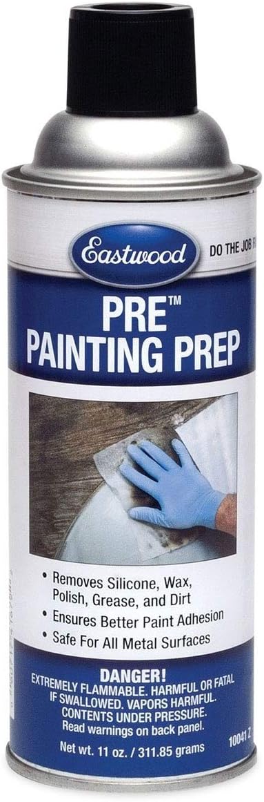

Try some of this stuff as your last step, right before you prime. https://a.co/d/iZE79gO
