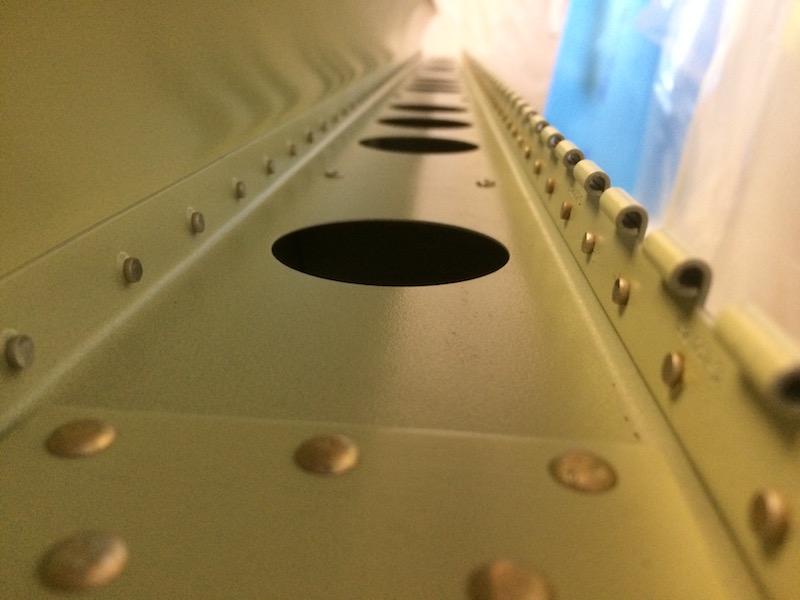

P60G2 is easy to use and super light. I sprayed every part inside with it and an HVLP gun. SEM is also an easy choice. No experience with Stewart. Feel free to e-mail. Happy to share tips.

I ended up with a 2K epoxy based primer used by airbus. It really is way to much work to set up and prep but the results are superb. So to sum up. I really wish I wasn't priming at all. It will slow you down tremendously.
My Process (takes a while):
Scuff.
Clean.
Acetone wipe.
Mix 2 parts (wait 30 min)
Add thinner
Spray parts
Then heat up booth to max temp possible for about an hour.
Parts are ready to withstand dimples and rivets the next day but it will develop chemical strength over time of a week or two.
Not sure if that helps at all. But pick your poison and move on to building. I spend months on this debate... I sure love the look of green "military" look on my parts... I guess I am a sucker for the classics.
