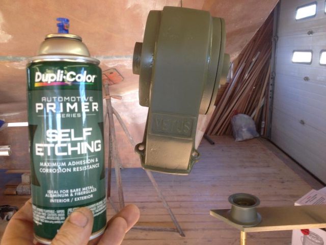

No I'm not going to debate the various primers but I felt I had to report what seems to be a big difference. My decade old build has gone full circle and I just started building a new set of tail feathers. I have used Duplicolor self etching primer over the entire build. Not a single problem and tough as nails. Now I bought some new Duplicolor primer and I see it is noticeably darker and chips and flakes like crazy. The can is also different the old has a light gray label but the new one is dark green. The old can has a part number of
DAP1690/B1736/RO 09:11 P VOC 60/1.20
The new has a part number of
EDAP1690 HL1414JJ P 1.2 04:30
I contacted customer support to ask about the "E" appended to the part number and got a "I'm sorry but I do not know of any formula change" response. I believe something changed because it chips like mad even when top coated. Any information on this from the great collective knowledge bank out there?
Thanks, Paul

Yes its the last one and the new dark can one
The thing I noticed is the paint color in the EDAP 1690 is darker green and that is one that is flaking in spots. The first batch you got from Amazon is what I used for the vast majority of my build. it is the DAP 1690. It has always been like cast iron and sticks like glue. The new stuff chipped off even after being prepped the same as always and sitting for a week. I may actually call the company on Monday and see if I can get to the bottom of it all. That would be just for my peace of mind. The next issue will be what I switch to so I can stop wearing kid gloves when handling the parts. Right now even dimpling is chipping the primer.
