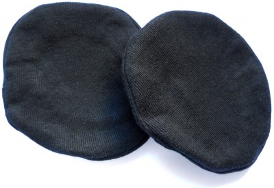

Like Don, I just fabricated a simple sock for the antenna out of black stretchy material. A few quick stitches and all is hidden under the antenna. Sits nice and flush. Just enough tension to fit tightly but not so much the white shines through. I have 2 like that now.
Like these headset covers...
