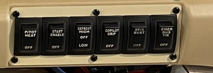

I know this isn't really answering your question, but have you considered not putting this on the stick grip? In my opinion, the negatives are not worth the small convenience. We put a flap paddle switch on the panel right above the throttle, which is where your other hand will be anyway.
Edit: just providing a visual of our layout. It couldn't be easier to reach this switch with a finger while my right hand is on the throttle control (which it will be every time you operate the flaps)

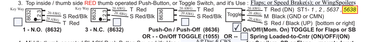

I'm 99% sure this is the correct switch to order.
100% agree.

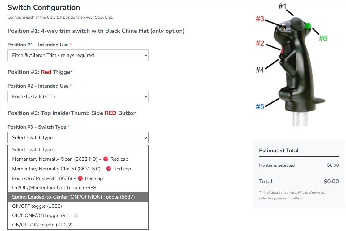

I've ordered multiple stick grips from Infinity (And helped with several others) and they are not offering this option any longer? I think Matt stated earlier this would work for the GAD 27? (See check mark for the 5 grips I have personally ordered, also stated above) Used in VPX and GAD 27 installs.
That was my bad. Did not see it in the pull down when trying to configure.
Sorry. Between work and this never ending project, my brain is oatmeal. Hopefully the guys at Infinity aero is respond in one form or another some day.
I think you guys got there, but the latest order form has both (ON)-OFF-(ON) (5637)and ON-OFF-(ON) (5638).
Only contributing because I snagged the latest image from the site.
