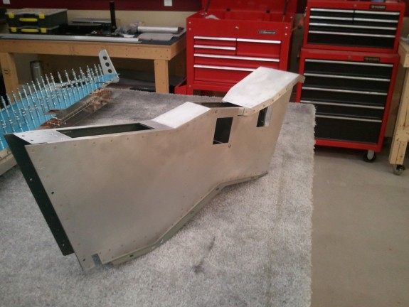

I built one from a long-discontinued kit.
Build Log Entry: Center Console Built…uh…
I actually don't think I'll be using it, though, so it may be up for sale (along with the throttle quadrant).

Hi. That looks a looks a lot larger than I would like, plus I live in the UK, but thanks for sharing.
I plan to have a simple box with lid just between the seats equal height to the outboard arm rests, with a hinged lid for storage.
I wanted the same thing when I was building, but I abandoned the thought after several people recommended against it. Hip room is at a premium in an RV-7, and anything down the middle really cuts into that space. There was another guy from the UK that built a nice console in his 7, but to use his words, he was "a skinny bloke". I don't remember his name, but the plane was a dark blue paint scheme...maybe a Royal Navy scheme. I just don't recall exactly, but maybe you can find it somewhere.
More important is under-panel access when you have to do maintenance. You'll end up going in from the side and turning upside down more than once for maintenance and inspections. Unless you have a small frame, you simply can't fit your shoulders through the space with something running down the middle of the cockpit. If the console is easily removable, then you can decide if it's worth the trouble. I personally find that pockets sewn into the side panels (forward of the instrument panel) or pockets in the back of the seats can hold the things a center console would hold.

My 6 has a centre console with a quadrant. It’s comfy for me, but I’m definitely in the “skinny bloke” category. Anyone much heavier than me in the passenger seat is a problem because the console means they can’t move their left leg away from the stick without being up against the engine controls.
I plan to remove it soon and fit an under panel mounted quadrant.
My advice is don’t fit a console!

I made a center console for the rv-9. one additional thing to consider is the fuel selector if you plan on having the console connect to the panel.
hmmmm... how do you stretch, how do you pee!?! Shifting around and stretching out is a huge advantage with a side by side. Keep things away from your knees and hips as much as you can.
This bears repeating. Whatever you do be sure it is removable, as getting under the panel generally requires more clear space than one would expect.
