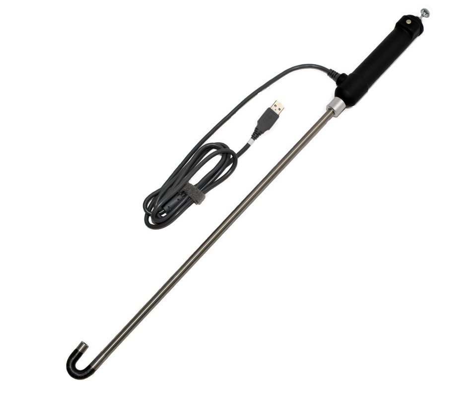

I bought a Teslong articulating borescope from Amazon for $118 bucks last June to use for my condition inspection. It can record images, has a slim probe so you can get it through small tooling holes, a lighted articulating arm and easy to view screen, plus you can recharge the battery via USB. I've been very happy with it.I want to check cylinders and valves. Anyone have good tips. Want to spend $100 or less. Thanks

I probably use it more at home than in the hangar. It's great for in-wall wiring projects. I recently used it for running a new water line to the fridge, and just yesterday used it to retrieve an AirPod that the cat knocked under the refrigerator.I have the Vividia VA-400, but the Vevor model described in post #3 is much, much easier to use. And less expensive.
The Vevor is a game changer for doing inspections also - looking for cracks and other important things in areas one could normally not see.

Vevor’s standard articulating endoscope will flex 180°, but in only one plane. Their 360° articulating endoscope will flex in multiple planes. That kind of steerability and flexibility is everything in fiber optic endoscopy. Especially given the price differential, there’s absolutely no question in my mind that I would buy the newer 360° version. Not to mention that they have almost certainly improved the optics and video processing.Does anyone have this 360 degree version of the Vervor? 360 Vervor

+1. I like it.I have a Teslong Two-Way Articulating Borescope, 5.5mm Slim Probe and love it.
The slim probe really makes a difference in certain use cases.
It recently failed after 10 months, I was getting the no camera error. But Teslong warranty / customer service is great and they sent me a new unit.
