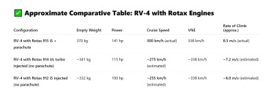

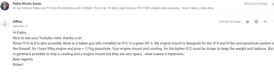

And that's why I spent days and days editing a video to show the two alternative engine solutions used in the RV-4: a German builder used the 915iS, and an Italian builder used the 912 ULS.
Does that mean I want Van's to build an RV-4 with a Rotax 912? No! But it can be a starting point in the search for an economical cross-country solution.

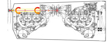

An RV-10 with two front-mounted engines driving contra-rotating propellers, inspired by the Macchi M.C.72, or a Push-Pull setup like the Do 335 — those really are nearly impossible.

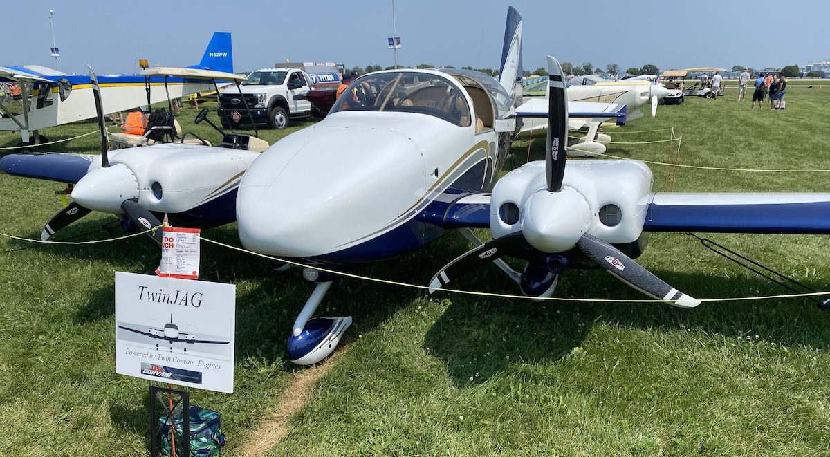

But with two wing-mounted engines, like this RV-6 Twin Jag… it just seems so straightforward. Don’t you think?"
