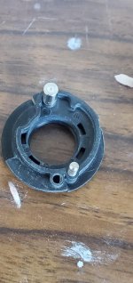

I was at the HF store store today the HPLV and HTE guns are exactly the same except for the nozzle at least as far as I can see. I could not unscrew the nozzle in the store. I think there is slight difference in the black plastic piece behind the nozzle.

Can some one post a image of the HTE with the nozzle removed like the 3rd from the left ? If the channels look the same I suspect the nozzles might be interchangeable( can covert the HTE to HVLP )
Photos
Photos of each side. HTE is 33psi.
A different nozzle/cap will also likely require a different needle.
When I inquired about getting another size nozzle and needle for a (Star S770) gun the cost for the few parts was about the same as for an entire new gun! Go figure!

HF does sell a few parts but not the Air Distribution Ring. That would have to be purchased from SATA dealer andnprobably cost more than a new gun.
