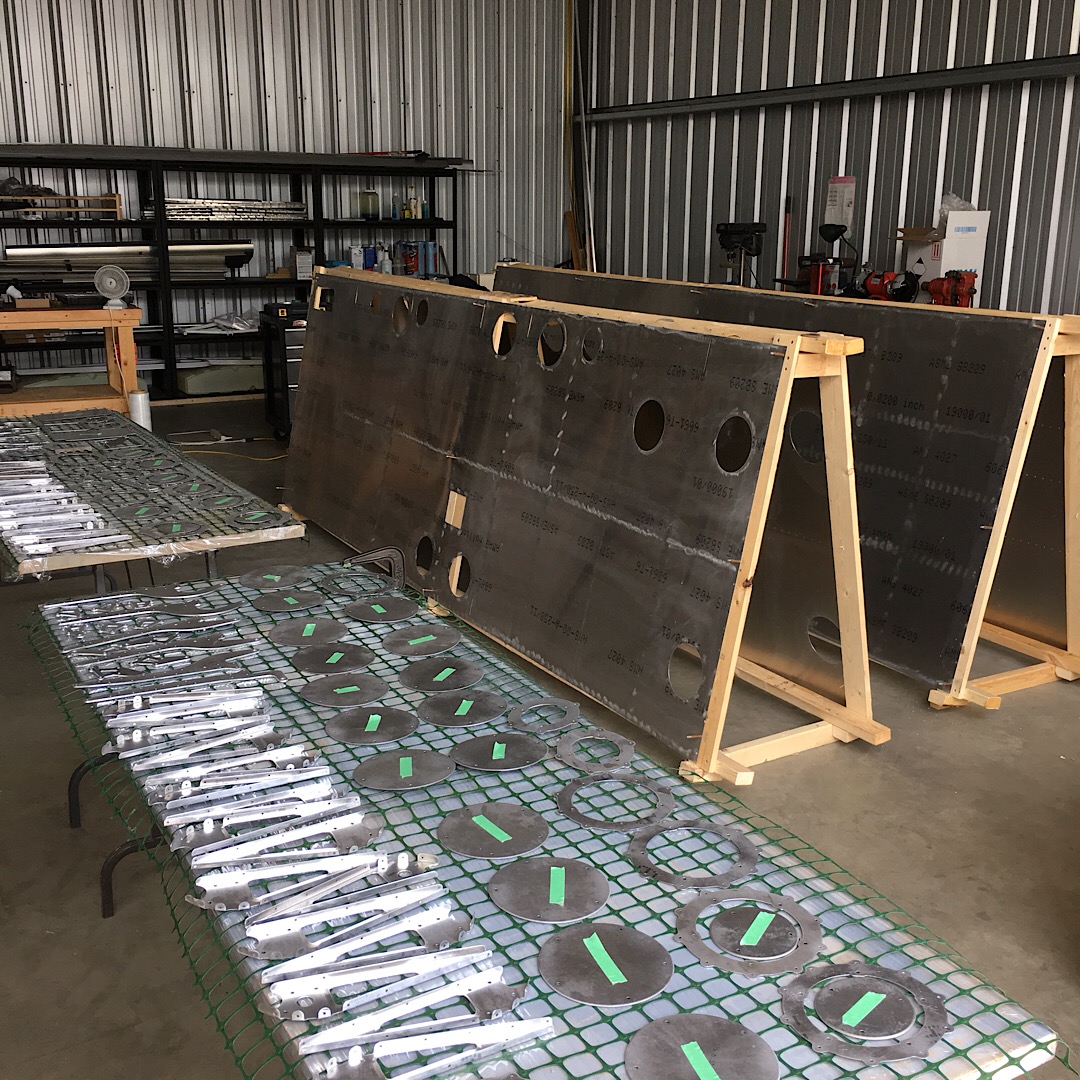

I did a quick search and found some photos but not a lot. I'm looking for recommendations or experience on how you prime your parts, specifically in large batches.
It took me to doing the tailcone to finally overwhelm my little table that I used previously. I use rattle can primer and would prime one side, dry, and flip it over to prime the other side.
I'm not planning on painting myself so a positive pressure paint booth seems kind of overkill. My current plan is to get some twine and string it between two points in the yard like a clothesline. This will allow me to get both sides at once and then let it sit and dry. The problem I have is the place I live is near the ocean and rains a lot. So I'm looking for some sort of portable solution like a garment rack that I can push in and push out.
Any pictures or suggestions would be appreciated!

I've got a few options. My "Go To" is my storage barn. I set a cheap baby gate on two saw horses and spray. P60G2 dries really fast so I can flip pretty much after the last pass.
Option 2 is for bad weather.

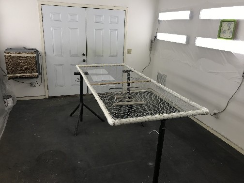

I have conduits strapped to my garage door frames. They are strapped so the doors still operate. I can suspend all sorts of stuff. My temporary paint booth is several shower curtains hung from the conduits plus on the floor and a ceiling. I use a bilge blower and dryer hose connected to a wall dryer vent in the garage. Same baby gate and saw horses are used as a down draft platform. Takes only a few minutes to set up and take down for a session.

I tried suspending my parts from a make shift clothes line during one of my priming sesions. It didnt work so well. The parts were hard to hold with one hand as i sprayed with the other. The PG60 drys so fast it is just easier to spray on chicken wire, wait 10 min, turn over and spray again. I found a lazy susan helps too.
I built a really crude wooden frame with some chicken wire attached. I would drag out my empty trash cans, put the frame over it, and then lay down the parts. Mind you, I live in a warm climate where this worked just fine 12 months of the year. At the end of the build, my trash cans were all fully primed. :D

I used one of the VANS shipping crates with some chicken wire as a make-shift spray table. For larger parts, I also use a piece of plywood with a 1x1 nailed along one edge that I can put on some saw horses.
Tried hanging things from wire but air from the spray gun pushed them around a bit. Still a necessary evil for some of the torque tubes.
Plenty of ways to make it work.
I?m really happy with the results from a quick trip to the hardware store for some PVC pipe, and half inch chicken wire, all pulled tight with some zip ties. Works great for shooting down through, weighs next to nothing, and I made it 7.5 feet long, so I could lean it up against a wall, vertically, if I ever needed to store it that way.

I found similar things to the other posters above. Eventually I made a "table" similar to Lance's, but I used a piece of leftover reinforcing mesh which I covered with chicken wire and I stand that on two sawhorses. I safety wired the chicken wire to the mesh, which gave me lots of practice with the wire and pliers.
Living in Oz the weather is usually pretty good for painting, though typically I spray on the wire mesh under my shed (with respirator on), give them about 20-30 minutes then hang outside in the sun or in the top of my shed from a rack to fully dry. I haven't used epoxy primer yet, just a good quality etch primer from a 4l can that I thinned down to spray. Whatever wasn't used I just poured back out of the gun into a jar for next time.

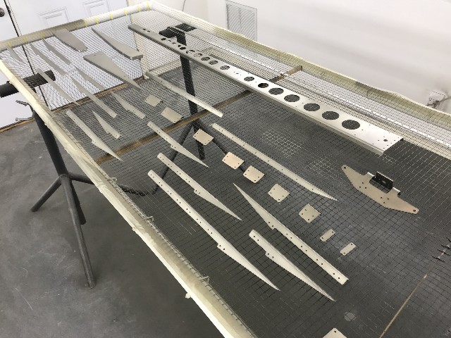

My favorite option for small stuff is an old aluminum window screen. Nothing can fall through it, and it's open enough to keep the air blast from moving the parts around. I just set it up on a couple of saw horses, garbage cans, or whatever else is convenient. If the sun is shining, I set up outside and the parts are dry enough to flip within a few minutes. I can then pick up the screen with all the parts still on it & carry it inside, if the weather is threatening.

Okay, LOL, don't laugh. See link to see what I've done. https://www.dropbox.com/s/r1t5pgizstkzf34/IMG_1950.jpg?dl=0
HAHA...but hey it worked actually pretty well. 20in x 20 in filter inside that I changed every paint job. The box fan in the back actually drew the air pretty well.

100% worth it. I did the first batch on the cardboard that comes under the skins. After chasing shear clips and doublers around I made a frame out of wire grid and furring strips. I put that on top of a couple of saw horses.
Things still move a bit but not nearly as bad. I use a piece of wire (insulation clip) to hold the really small stuff down.
And the parts don't stick to the top like the cardboard.

I cut a 4' furring strip and drove brads every 2" then cut the heads off. Virtually every small part has a hole in it. I just slip them on the nails and spray. Flip and spray. It actually works great to keep not so tiny parts from blowing around.
