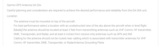

My setup has a Garmin GNC355 and a Dynon Skyview HDX system. both systems have their own GPS receiver. I also have a Garmin G5 as a backup.
The G5 has a coax input for its own GPS receiver, but also according to Garmin, has its own internal GPS antenna. I assume it is also receiving GPS data from the GNC355.
What's the over/under on giving the G5 its own antenna? Added weight. Added cost. Is there added redundancy or accuracy? Since it's only a matter of adding an antenna now, I'm inclined to do it.
Thoughts?

FYI, the G5 when installed as an ADI per STC requires a GPS source, either an approved navigator or an external GPS antenna.

Depends on your plane and wiring. I put it center panel in an RV-9 slider (center steel brace) and the internal antenna couldn't pick up enough satellites. Rather than the $200 Garmin add on antenna, I found one online for less than $30 (not an option for an STC installation) that had a BNC connector and it worked great with just the puck on the glare screen.
Interestingly, I moved the G5 to the left side of the panel during a rework and the internal antenna was sufficient.

Worse case scenario... It's in the panel in case of total electrical failure (ie, electrical fire). In this scenario it's working all alone. It needs it's own solid GPS signal.
Yes, listen to Walt ;) - I have had personal experience losing attitude information on the G5 (standalone) that did not have an external antenna. After adding the antenna, the problem was resolved.

My actual set-up started 5 years ago when I installed a single G5 as a primary AI in my then VFR ship, no external antenna. Having the G5 loosing attitude and going into ALIGN whilst flying in moderate turb one day, and recovering more than 10 minutes later, luckily in VMC, was food for thought.
Since I wanted an IMC capable configuration, the next upgrade to a dual G5s (used as primary flight displays) and a GNX375, saw the addition of an AV20S as an eventual life saver. In normal ops the G5s get their GPS thru the GNX's 375 WAAS antenna, and I never had a problem. Until that day last year, when flying thru the Alps again in moderate turb with the GNX375 offline, and guess what... the G5 went into ALIGN. Garmin had a look at the data and confirmed that the G5 had lost GPS signal from its internal antenna.
In short my guess is that, depending on installation, a standalone G5 is susceptible to loose GPS acquisition one day. Not a problem in VMC, but serious IMC flying would require an external GPS antenna.
