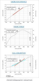

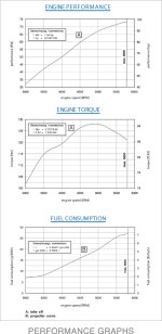

It's hard to find authentic torque curves for these engines but this would strongly suggest that the curve is NOT FLAT. I goofed on that. The screenshot is listed as applying to the 912.
But please note in the attached power chart that the chart is for CS props. With that caveat, if you want to see how MP relates to HP this offers some data points.
The 3-frame picture shows the relationship between fuel consumption and other parameters including torque.
I edited it with red and blue lines to show the HP vs GPH. If I understand the graph correctly, HP rises a bit faster(with RPM) than GPH but the relationship is close. I would have to check how the numbers are used on the vertical axis to be sure; it could be a matter of how the axis is scaled. Both are pretty flat in the range of speeds we use for cruise.
Since torque increases with RPM I would expect power to rise faster than RPM, proportionally. T x R / 5252 = HP. If T were flat then HP would rise in proportion to RPM alone. If T rises at the same time as R then HP rises as the product.
