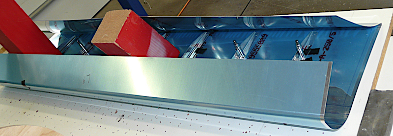

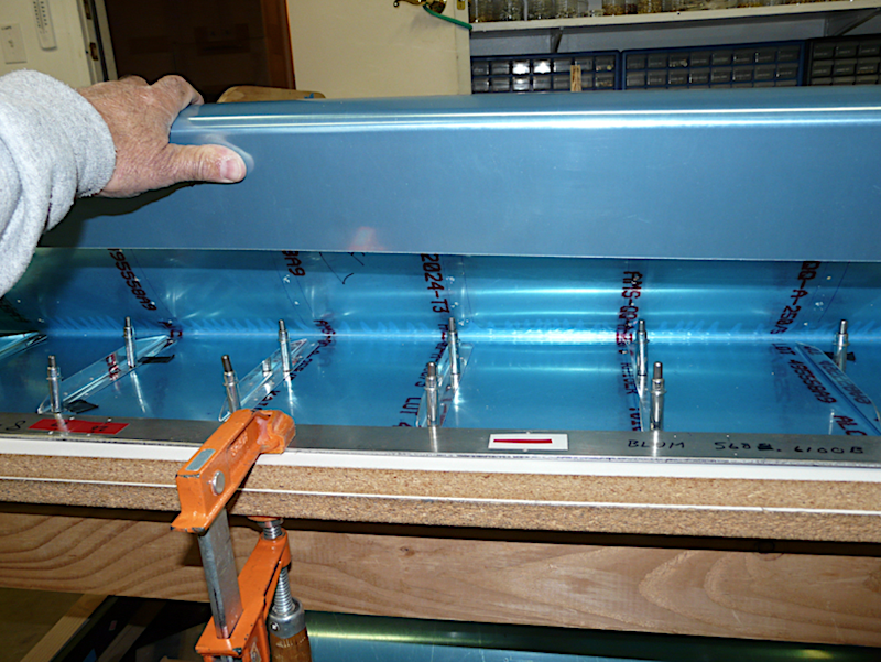

Default Horizontal Stabilizer Finished
...Except for the tips, that is.

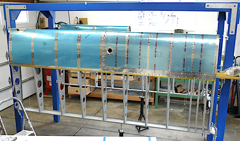

I put it under the window in the sun to relax for a while. This is the second one, remember, since I scrapped the first (it's in the rafters now).
Incidentally, the first took 201 hours to build and this took 104 hours. This one's a keeper.
After cleaning the shop I continued work on the rear spar of the vertical stabilizer, deburring the holes and dimpling the channel and countersinking the doubler. It's only the bottom 10" of holes that get this treatment, since that's where the spar rests against the last fuselage bulkhead.
Dave

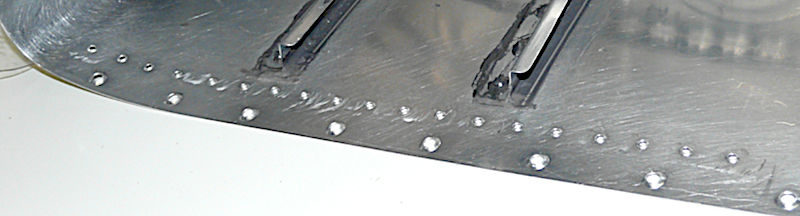

Default Vertical Stabilizer Complete

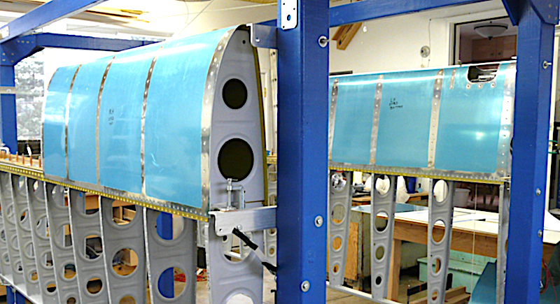

This one was fun. In my opinion it should be done before the horizontal stabilizer - it's cheaper and simpler.
Dave Dooley helped me rivet the forward spar to the skin and I did the skin to the ribs during the presidential debates last night. Today I finished that and did the skin to the rear spar.
Here's something that might be worth considering. The skin and the flanges are .032. I used the substructure dimple dies from Cleaveland for the underneath parts. I used the rivets that the plans suggest, AN426AD3-3.5 and it was hard to get these consistent. It turns out that the standard rivet measuring tool measures .139, while the rivet spec on Van's site says the the minimum diameter of a shop head should be .122 inches.
I got a piece of scrap and drilled a .125 hole. This gave us a minimum "go" gauge. We used the standard rivet gauge as a maximum "no go" tool. We made sure that none of the rivets would fit in my homemade gauge, and that they would all fit in the standard one.
This gave us shop heads which were within the .038 to .050 high specification. I used a 4" digital caliper from Harbor Freight to measure these.

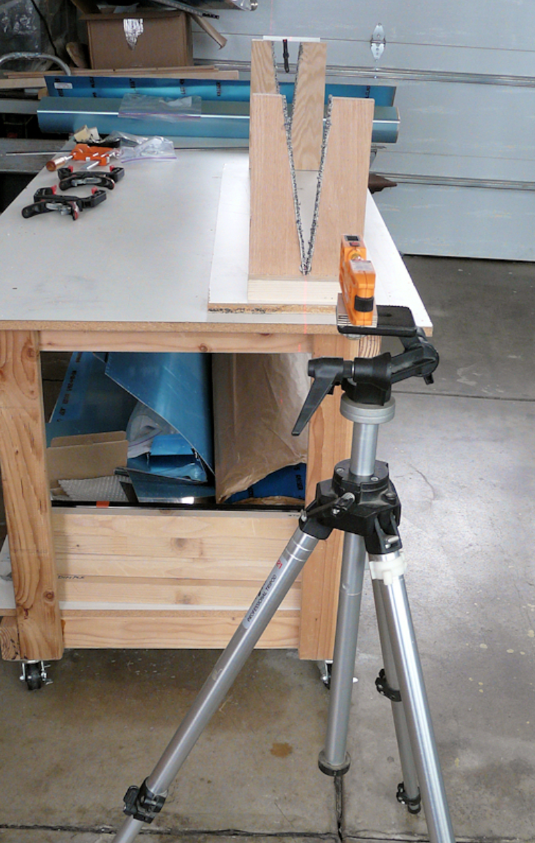

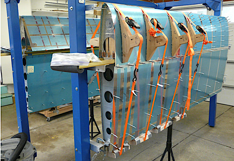

Default Moving Along

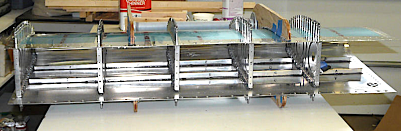

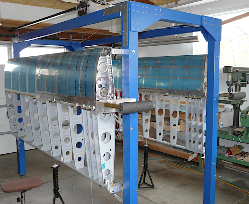

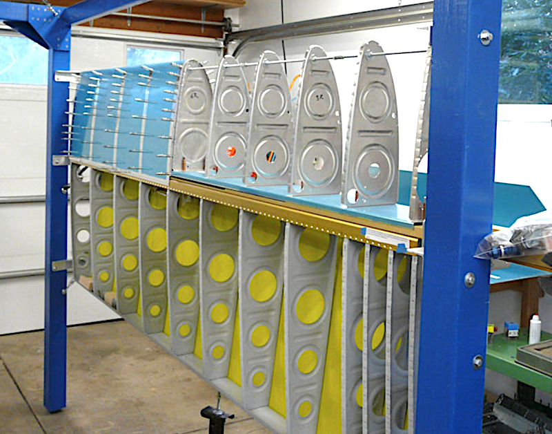

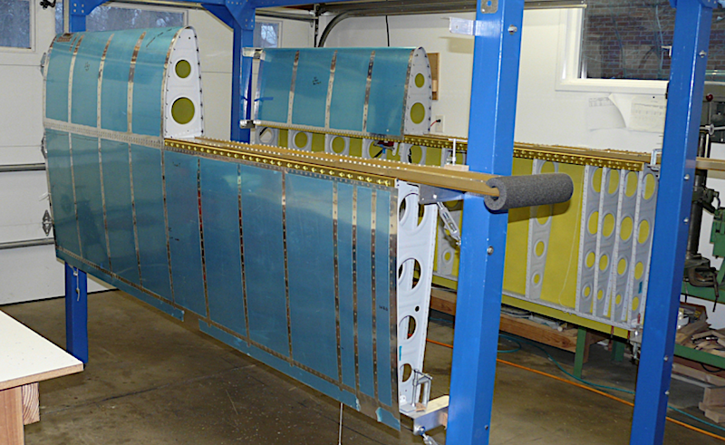

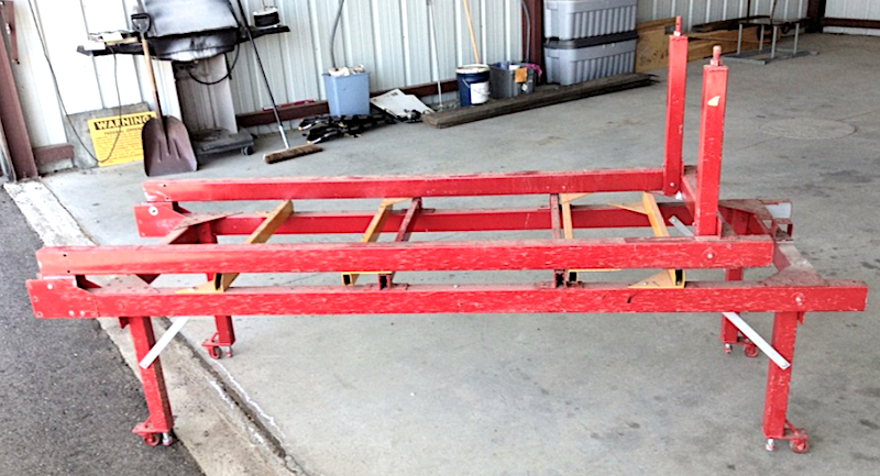

I disassembled the empennage jig today. That thing has been wonderful. It's been very solid and adaptable and worked for both the horizontal and the vertical stabilizers.
The yellow piece closest to us is the main horizontal member. The triangular ends make a fork that fits around the wood which you can see on the yellow vertical stands behind it. The wood pieces face each other in the photo.
Then there are three large bolts which tie the vertical pieces to the horizontal piece. You can see the holes in the nearest vertical post.
The blue beam, a box made of 1 X wood, screws to the top of the vertical posts. The box is relatively large and provides huge stiffness.
Finally, the feet are 1/2" bolts through the ends of the vertical stands at the widest parts. These are individually adjustable. I used a quick-drying body filler to secure these to the floor so that I couldn't push the jig around. A chisel removed the body filler.
I'll sort of miss it. It was a good tool. It's made four or five sets of stabilizers so far and is in good enough shape to make several more. But it goeth back from whence it came.
In the background, nestled quietly in the workbench, you can see the skins for the rudder and elevators. Other parts are on other worktables. The focus has already shifted.

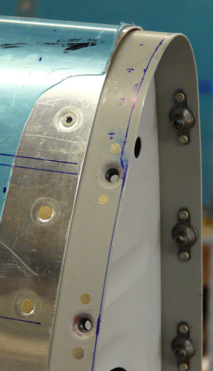

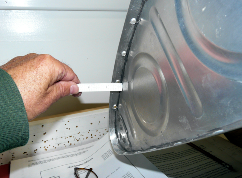

Here's a trial fit-up with the vertical stabilizer on the bench. At this point the leading edge of the rudder has been formed but not drilled nor riveted. I remembered the strips on the bottom to attach the fiberglass rudder bottom. These are visible at the left.
After some tweaking, I riveted it up.
I still need to do a final adjustment to the bearings but this is about it. You can probably see that I used gray SEM primer for the spar and ribs but yellow zinc chromate for the skin. I think that the zinc chromate probably gives some additional corrosion protection, and wanted to try it out.
Incidentally, those thin jam nuts on the rod-end bearings aren't to prevent it from turning. They carry flight loads (axial and bending), and should not be overlooked.
In the bottom photo, you can see some regular marks on the rudder skin. Look carefully and you'll realize that they are reflections from the drill board behind the rudder.
