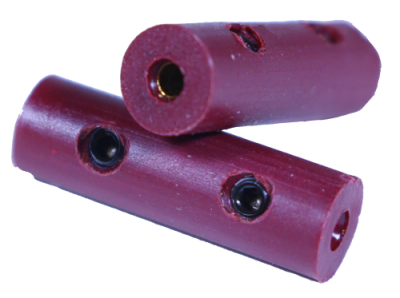

EGT / CHT gremlins that were traced to bad splicing has made me a believer in the EI WIRE OVERLAP CONNECTOR / SPLICE OLC-2 for that particular application.
Yep. Yep. These nylon barrel overlap connectors with set screws are my favorite too for EGT/CHT probes and any other signal splices under the cowl. EI developed these after years of complaints about the original spade connectors. Most electronic engine instrumentation problems can be narrowed down to bad or intermittent connections. These EI overlap connectors will eliminate a lot of that as long as installed per instructions. EI puts them in all their modern engine monitor kits and will sell a package of just connectors to anybody who wants to retrofit whatever brand of existing probes they have.
