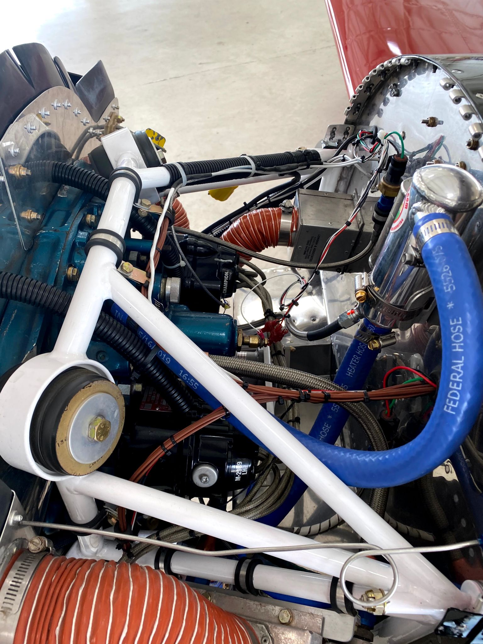

I have a picture from under the cowling I took a little while ago, and it looks like I already have these pointed at the mags - I forgot all about it I'll have to measure them to make sure they're the right size, and potentially run safety wire through them as suggested by Paul.

Hi Tass, has that engine ever flown? Sure looks clean. One question - what is that hard line with the loop at the bottom of the picture? Primer?

It's a photo from a little while back, so maybe slightly less clean today, but I'm fairly regularly under the cowling and try not to let too much gunk accumulate (but boy oil changes with that screen housing make that difficult!)
The hard line goes to the firewall, then has a tube to a MAP sensor.
