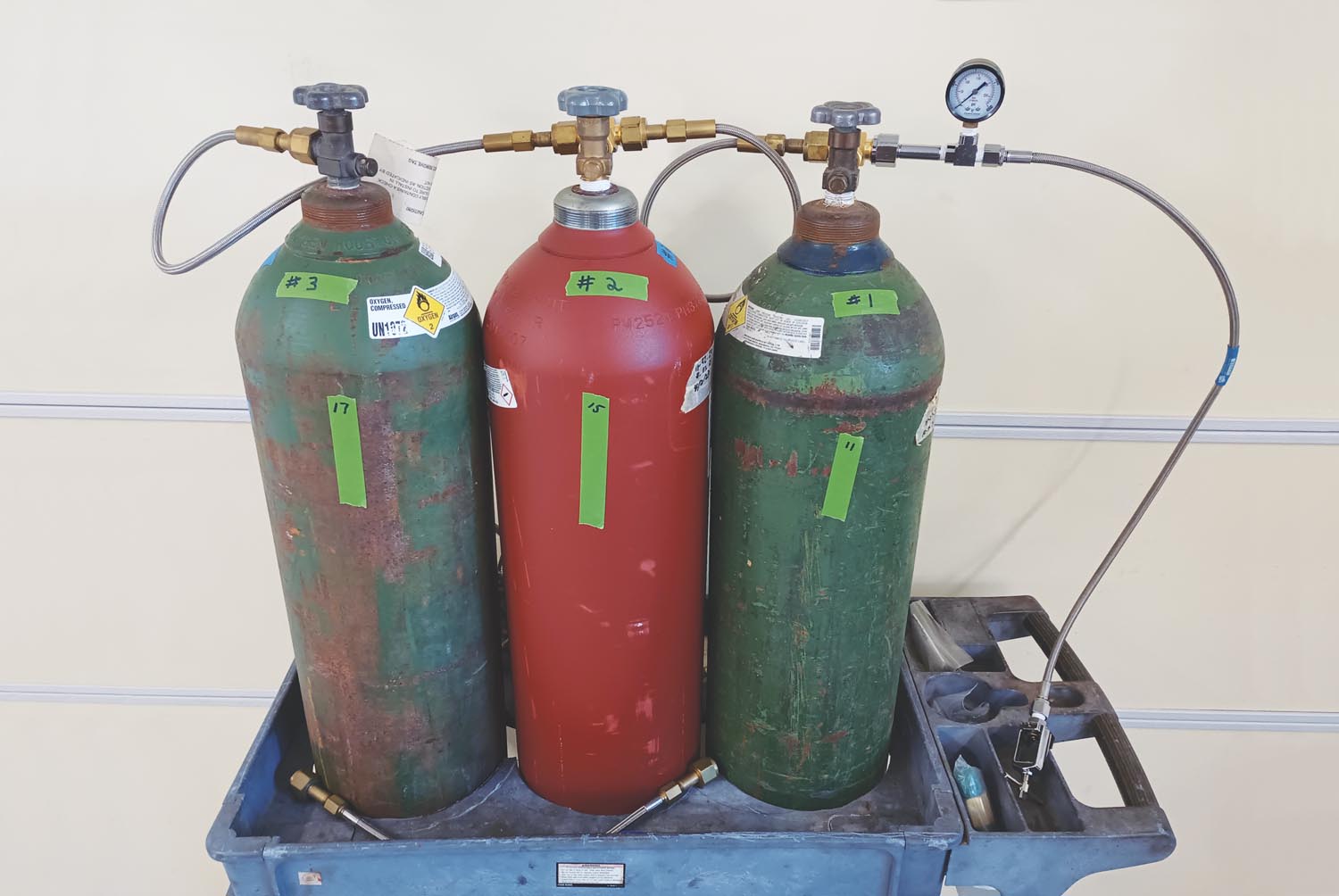

The concern over declining pressure in your aircraft bottle can be mitigated to a large degree with a trans fill bottle system using two or more bottles. I purchased my system from Precise Flight who was bought out by AerOx. They have quality stuff.
I fly to the mountains several times a year and I've been self-filling my tank using welders' oxygen at least the last 7 or 8 years. If I change a trans fill bottle out, I fill the aircraft tank and put on the canula while on the ground and breath for awhile to satisfy myself that the tank is ok to use before I fly with it. You can use a pulse oximeter on the ground to verify if you want to double check.

It's been several years since I checked but when I did, AirGas here wanted 150 bucks for an aviators oxygen bottle to fill the airplane bottle from. And it is special order. They don't stock it here. A one size larger welding oxygen bottle bought a few months ago cost $35. One large bottle will last me years. I keep track of my fill ups by using a sharpie pen to mark the date and beginning and ending pressures on the big bottles. IIRCC the last set went 4 years. When the pressure eventually gets low enough that I can only get the airplane bottle about 3/4 of the way full I take the lowest pressure of the bottles and use it on my oxyacetylene welding set up and buy a full bottle for the airplane.
But there is an investment in a tran-sfill hose and purchasing, (I don't rent) the large bottles from the supplier. For me, it has worked well and saved me money in the long run. There was a post not to long ago on VAF where I believe an FBO was trying to charge $150 to fill a bottle which is robbery plain and simple.
