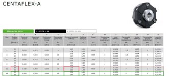

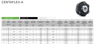

You're going to replace this thing with something better anyway. 100 lbs-ft nominal torque suggest a size 12. Replace the driving end with a flat disk (or better, integral, a new flywheel with a thickened center) drilled four places for Type S pins. Used a splined Type 1 slug on the driven side. If the existing splines are standard SAE, use a Type 1 L-LOC, which would allow slipping it onto the splines and clamping rather than using some variation of the press method. See attached.
Note the Centaflex A coupler places the rubber elements in compression when the radial fasteners are tightened. There are no tension fibers buried in the rubber.

It looks like a Centraflex A size 12 coupling (140Nm nominal torque rated) is about Euro 120. The Michigan based distributor is still going to get back with me... This is for the outer element. The inner element is probably going to have to be custom made to suit the spline on the gearbox shaft. Its circular on the outside with 3 tapped radial holes to transfer the torque.

DanH I see there is a way to register and get CAD files. PDF Catalog shows 3 holes in the photos and no axial view so no way to determine how many holes there are. But I see the online product catalog (not the PDF) shows individual elements with a picture and basic spec.. Would you suggest trying the lowest shore first ?
Complete dimensions in the catalog, see below. A #12 has 4 lobes at 90 degrees.
Selection is the usual balanced compromise. As you know, it's not really a matter of Shore hardness, but rather, dynamic torsional stiffness. Design goal is to move the fundamental resonant RPM below the normal operating range without allowing the F2 to creep into the upper end of the range. Less stiffness will move it lower, more higher. In the optimum case, you would model the system with the available stiffness values to see where things land. However, in this case I think it is reasonable to experiment.
So take a good look at the torsional data for the #16 as well as the #12. The #16 is a three lobe in a slightly larger overall diameter and thickness, and thus offers even lower dynamic torsional stiffness values...while at the same time increasing the allowable nominal and vibratory torque. The issue might be max RPM, 6000 vs 6500. I don't know the max for the Fit.

If you have the physical space for it, I think I'd try the #16 in Shore 50, with the backup plan of a Shore 60.

Great post Dan. The size 12 is approximately the same size as the current giubo and the 16 is basically 6" OD.
I actually think the #16 will be easier to mount because its bolt circle will be outside the flywheel bolt circle where the 95mm pitch circle of the BMW part puts it very close to the flywheel pitch circle making it harder to accommodate. The pitch circle of the #16 being 125mm should work nicely on a manual transmission flywheel. Unfortunately my R18 engine is in the hangar so I couldnt take a picture of that, since it has a manual transmission flywheel on it, but attached a pic showing the 125mm bolt circle dimension on the existing flex plate.
