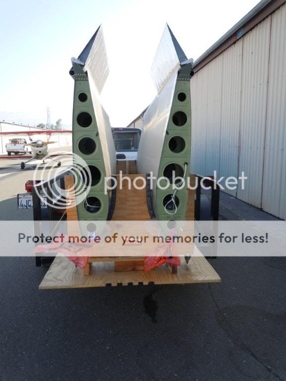

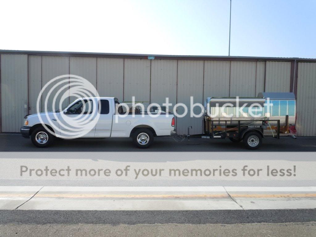

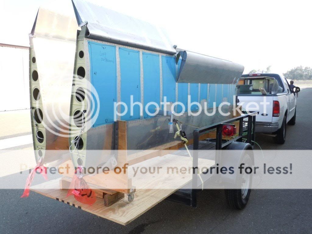

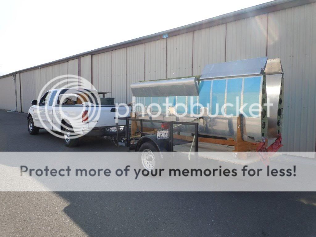

Wings go for one last ride!
Today, my wings took a ride from RHV (where they have been spending the last few years in storage) to E16. The next time they will move a significant distance they will be producing lift!
Thanks to my friends Brian (RV-7 in progress), Paul (co-pilot extraordinaire and fellow guitar picker), and Gary (neighbor and the owner of a great trailer).
Next weekend, the fusalage leaves the garage for E16 as well.

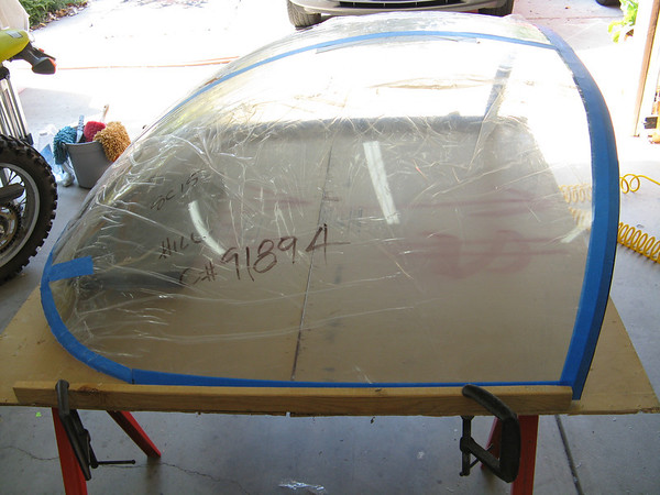

Nice job Bruce. Check off another high pucker factor job from your list. What did you end up using to cut it with?
I used the cheap Harbor Freight die grinder and the disc's that Van's gives you to cut it. Gave my poor little air compressor a workout. ;) Temps here in SoCal have been mid 90's, so plenty warm on the plexiglass. Still need to clean up the rear edge with a sanding block to get it really straight, then trim up the rear window.

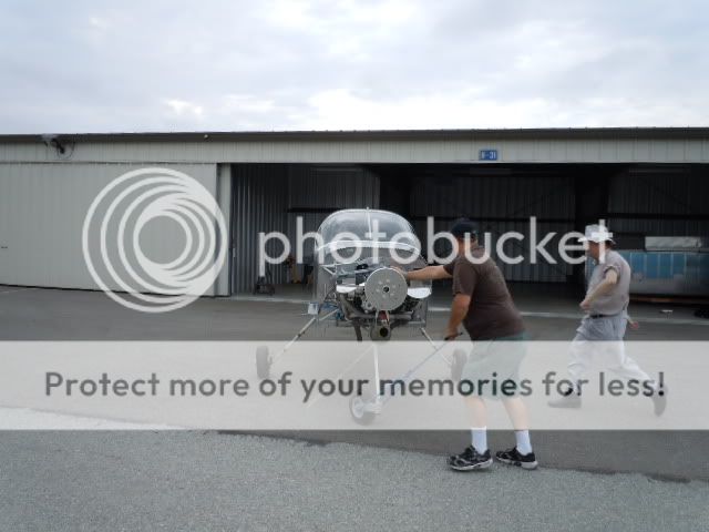

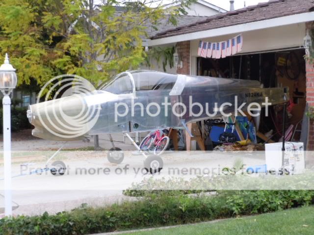

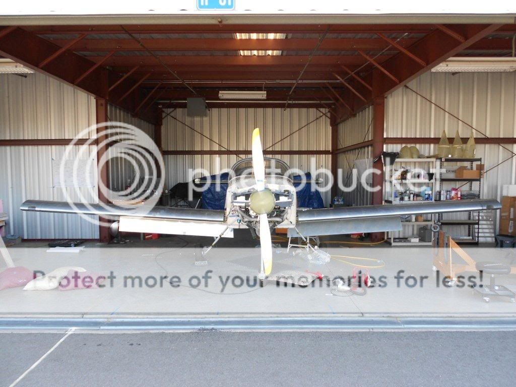

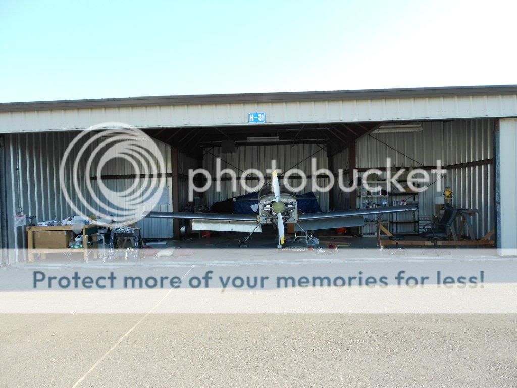

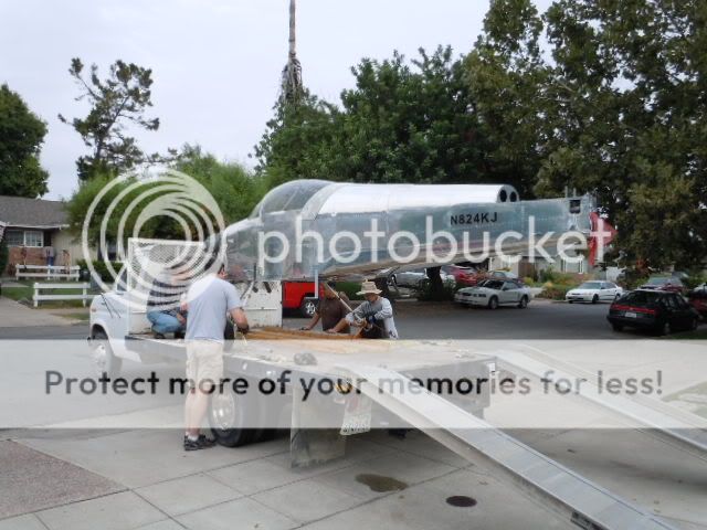

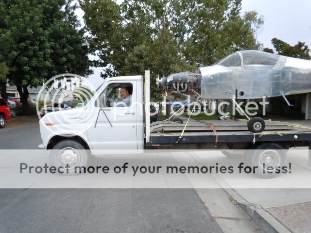

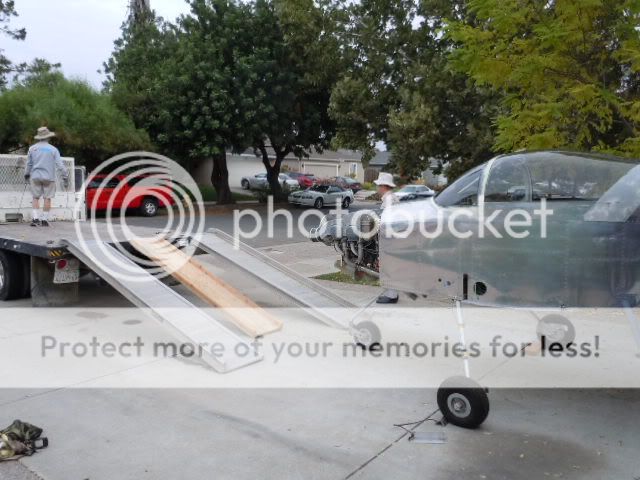

Move to the airport, part II
Last weekend, I moved the wings to the airport. Today, I moved the fuselage.
It went very well! It looks quite at home at the new digs.
I want to thank the following people for making this possible today:
Bob Mackey (sorry I was such a backseat driver :eek:)
Jason Beaver
Don Lindsey
Anthony Scott
my son, Craig Johnson
Chris Hand
David Martin
and last, but not least, Cooter the flatbed truck.
Congrat's Kelly,
As mike said, now the fun begins.
The best part of getting it to the airport and into the hanger, is it now seems to come together in big leaps and bounds. I know how exciting it is, once it is on the way to the hanger. And every day from now on it just seems to get more exciting. Enjoy it, you deserve it, because of all the hard work it took to get it to this point.

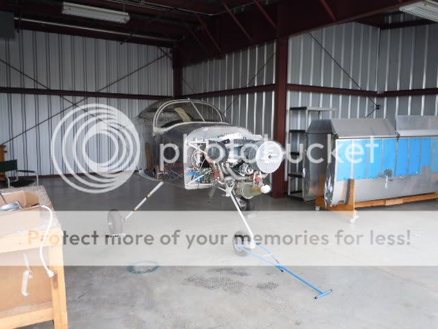

Thanks guys!
Seeing it in the hangar is really exciting!! The amount of room there is incredible compared to the garage. I'm temporarily storing my HS actually on the plane until I get a chance to install the tail for good next weekend.
Too bad work is impeding my airplane building!! ;)
Unlike "normal" people, I think my garage looks weird WITHOUT an airplane in it!

Better start thinking about that next project then!
Yes, not only can my dog not believe it, my wife called about 3 minutes after we left the house to the airport to let me know that both my girls were crying. Neither can remember a time when there hasn't been an airplane in the garage (one was 2 and the other 5 when I started). They're not quite sure how they're going to deal with that void, or where they'll go to find blue vinyl to draw on!
Now that I think about it, it does look quite lonely in the hanger!

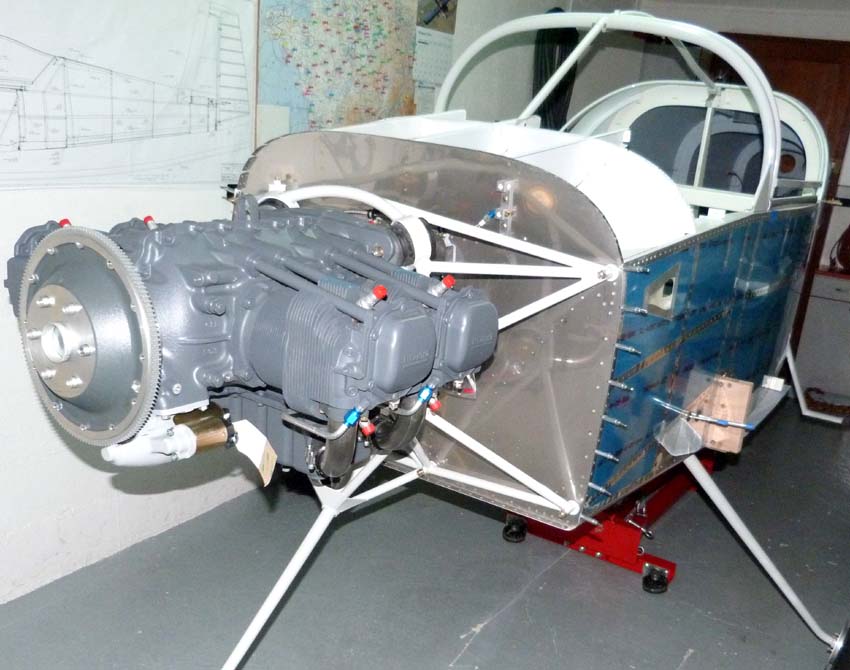

Engine hanging done !
I have done my engine hanging without problem but honestly it took me a little more then three hours to have the job done, included the cotter pins.
Lycoming YO320D2G.

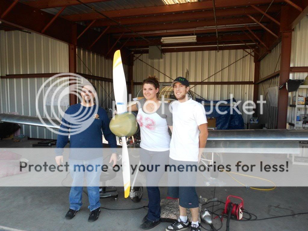

Partial success with wing installation
Today was a huge milestone for me. After gathering a whole crew a week ago only to have it all go bust (I wasn't as ready as I had thought) I got the wings on today. Now I still need to install the nuts and torque everything up so I know I'm still not out of the woods but it sure feels good.
This weekend I gathered my good friend Paul, my daughter Gianna, and her boyfriend David and we knocked it out. It took us about 4 hours from going from wings on saw horses to installed with bolts in place(less nuts). Not too bad. It made for quite an RV grin!
Really, the bolts didn't fight us too much. I froze the bolts (which I don't think added much to the party) and applied liberal white grease to each bolt. A few light taps with a hammer got each bolt started and then tapped them home with a rivet gun. I made sure to not push the bottom bolts too far through the holes. Too far and you'll have a heck of a time getting the nuts on.
I'll get the nuts installed and torqued by the weekend.
This part of the build is a lot of fun!!

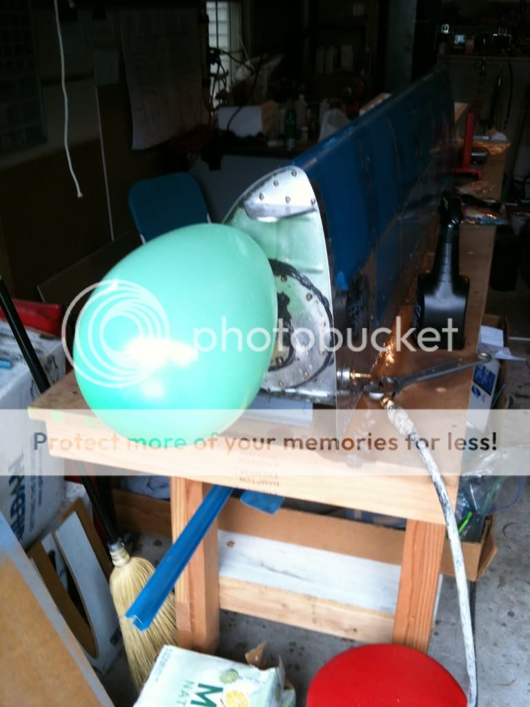

Tanks and Leading edges complete
Both tanks tested leak free and they are on the wings with minimum hardware. The leading edges are riveted to the spar. Top skins here we come.
Great job Denis! Go ahead and bolt the tanks in place now. You will have no need to remove them and it is easy to get torque the bolts without the skins on.

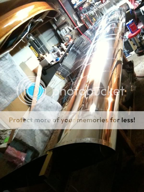

Finished Left Wing
Finished-up the wing with the help of a friend tonight. Getting those bottom skins on wasn't as challenging as I expected... 36" long gorilla arms helped :D
So bright and shiny it's hard to take a good picture.

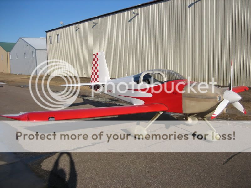

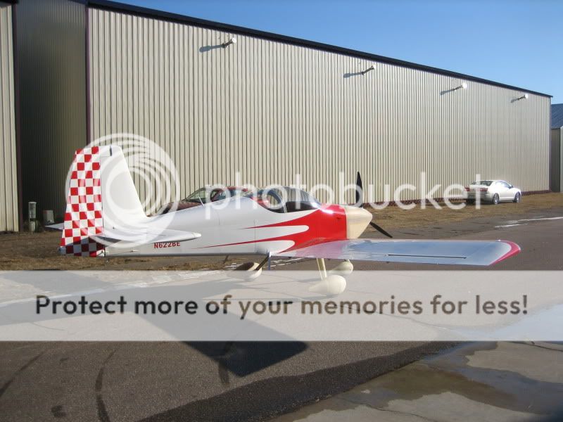

Ready to go at last
After a six year build RV-9A 91317 N622BE is ready to make it's first flight. If the weather is good it will happen this coming Monday.
Equipped with an AeroSport O-360-A2A, dual Lightspeed ignition, Catto 3 blade propeller,
Dynon D100, D120, dual axis auto pilot, Garmin SL-40 and GTX-327, Flight Cheetah FL210 GPS.

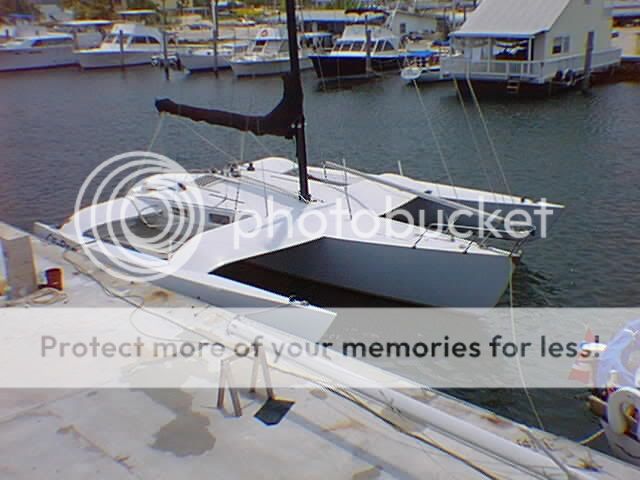

Although this is my first plane, it's not the first thing I've built that has had wings.
That belongs to the sailboat that I built back when I was in my twenties living down in Key West.
41 feet long, 27 feet wide, foam core fiberglass.
And yes.... it did FLY!

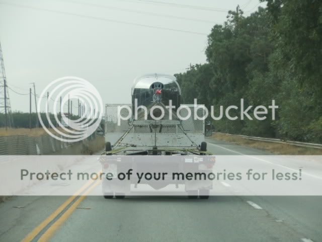

Fuselage goes to the airport
After a lot of work finishing the paint and related cockpit chores, N942PT (reserved) was loaded on a friendly aircraft carrier, also known as a tow truck, and hauled to the assembly hanger. Upper molars were added for aesthetics. Flightline interior to be installed after we take the wings to the hanger and make it look like a plane. All parts are now painted with a few areas to be buffed. It is nearing time when we can finish assemble the plane and work towards first flight.

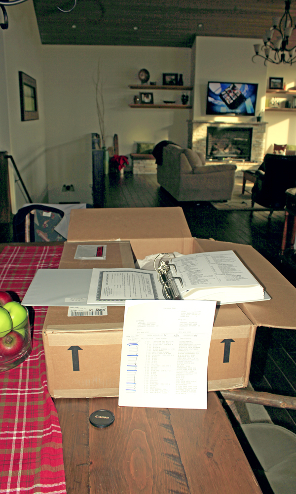

The build of 92094 begins!
Well, enough dreaming, time to build. the first parts of my kit came today. It was scheduled for Monday so I was surprised to see FEDEX drive up the driveway. I snapped a quick picture of one of the boxes on the dining room table and will start inventory this evening. It is lightly snowing outside, so I'll put it in the garage tomorrow. Now all I need is tools!

No 49ers or Denver, so no game! As I unpack and make sure everything is here, I figure the guy who packed this must have made fireworks in an earlier job. I have never seen so much paper!

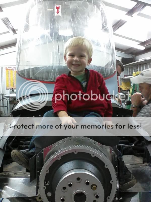

Last Rivets
Last evening my son and grandson came over and helped me set the last of the rivets on the top forward skin. I'm trying to get everything done that I can at the house before going to the airport. List is getting shorter!!! Gear leg fairings, heat shield in the lower cowl and prime the outside of the cowl, wheel pants and gear leg fairings!! It's getting exciting now!! Only 90% to go!!
Picture of my "helper".
