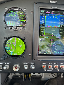

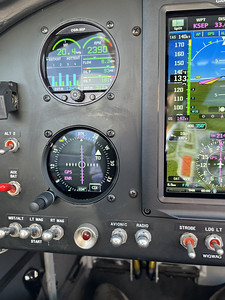

When it asks to load the IGRF database, I choose OK then it just sits at this screen for hours.
It is possible this could be caused by removing your microSD card too quickly after the update. Can you try re-insetting your datacard and powering the unit up?
Justin
Justin,
I am seeing the same thing as this user. I let mine sit for an hour on ground power and it never found its way to the next screen.
Justin,
Good evening,
We have pushed a new version of G5 v8.17, detailed here.
You may need to try a couple micro SD cards to find one that works to load SW and the IGRF data.
If you are unable to find one that works, please reach out to us at the email below and we will get a working SD card sent out to you ASAP!
