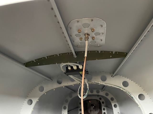

One issue I am concerned with is antenna placement on the RV-12. I went the most simple route and added it on the shelf over the engine, under the cowl. That shelf is lower than the top of the firewall of course. After several months of experience now, I'm occasionally getting loss of GPS satellite integrity. It comes back in a few seconds.

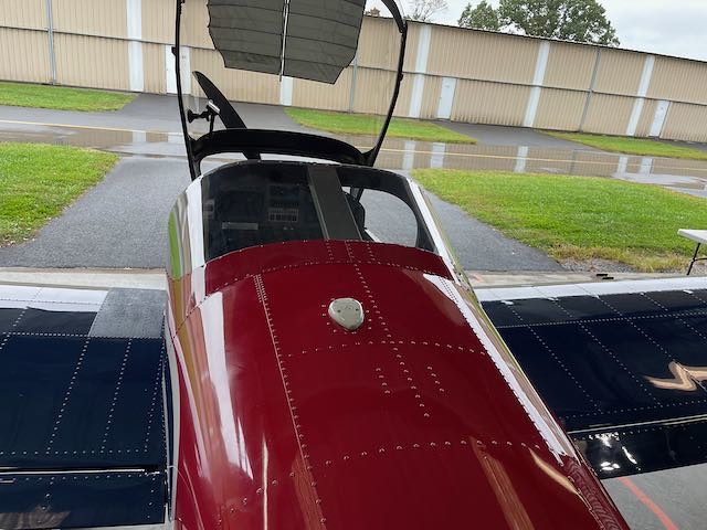

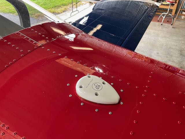

I finally got around to relocating the GPS175 antenna from where I had originally installed it (under cowl, on shelf beside the Dynon ADSB-antenna) to the topside of the forward tail cone. After some long flights, it was clear that the under cowl location would regularly lead the Garmin unit to "reset", drop all the satellites and begin to require them. Process would take 10-15 seconds and if I was on an approach I would be required to go missed. Not acceptable.

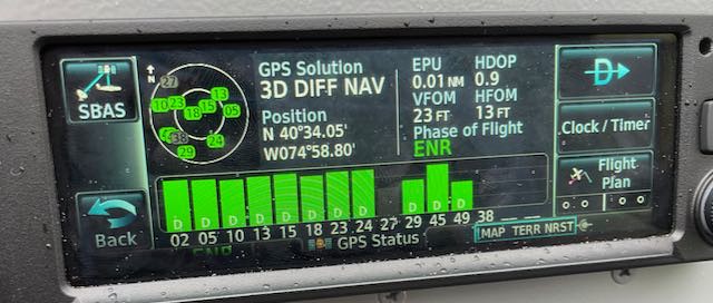

Below is a shot of what the satellite reception was when the antenna was below the cowl. Again, it worked "most" of the time, but would lose adequate satellite coverage periodically.

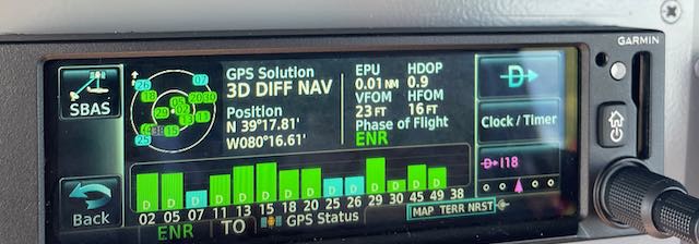

Below is just the initially start up with the aircraft sitting on the taxiway between two hanger rows, so it was not in a normal flight condition. Already it is clear that the more exposed location is substantially better. I've conducted one short test flight and so far not a single failure. A little touchup paint and I'm done.
For anyone considering the addition of a WAAS GPS unit for the 12, while the undercowl location for the antenna might be attractive, its just not reliable for consistent reception.
