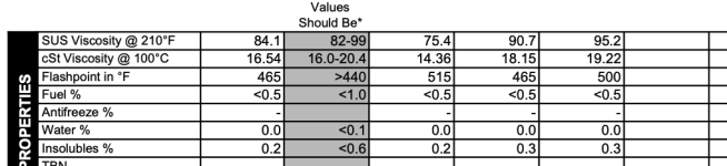

My Blackstone reports show zero water in the oil. I use an engine dryer, not sure if that helps with this part of the oil analysis. They recommend that water in the oil should be kept low, but I don't have any comparison info.

I wonder if the engine dryer is enough to remove combustion water. Sure seems like a cool engine is a good thing.

I don't think that an oil analysis would ever show water. Water and oil molecules simply don't bond. put a bit of oil and water in a jar and shake aggressively until mixed. Come back tomorrow and have a look. A high pressure pump can churn it all up and mix it together, but once that stops, the oil and water will eventually separate and stratify. Maybe it separates out in the sealed container and blackstone agitates it to mix the water back in before going to the Mass Spectrometer. This would make sense, as they advise to drain quickly after shutdown for the sample. Maybe this is why.
