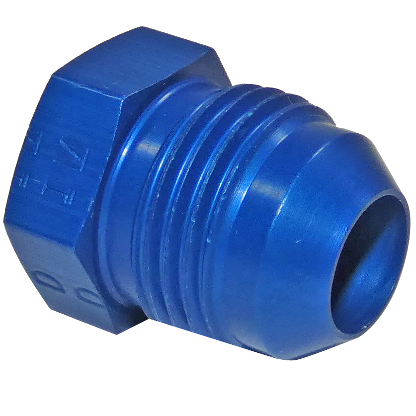

Plug off the brake line as soon as you disconnect it. Plugs and caps can be found at Aircraft Spruce. You can also use brass fittings from hardware store. You are only going to install finger tight 45 to 37 deg. no problem.
