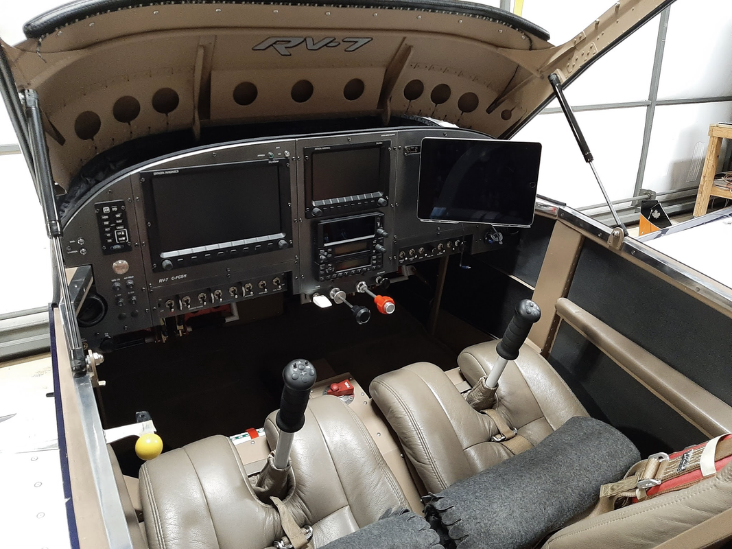

Hi guys, just wanted to post the final photo of my upgraded Canadian IFR panel.
Yes I do have a E2B compass, behind the IPAD, never used it and probably never will.
Thanks Claude for some ideas of what the TC inspector wanted to see in terms of paper work. I found transport Canada to be very efficient, it was just a paperwork exercise.
Happy flying ,
Before and after photos. 500 hours and a few months of work.
Simon Hitchen
Port Perry, ON, Canada
7 Tip Up, Titan XIO-360, Dual P-Mags, Airflow Performance matched Injectors, Sensenich FP Prop, 2 Dynon Skyviews, GPS-175, GTR-200, GTX-327. Day/night VFR/ IFR

Looks great Simon. What are you using as your second navigation source? I don't see anything on the panel.
Do you have problems with the iPad overheating in flight with it being that exposed?
