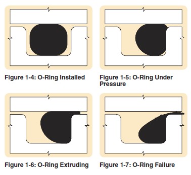

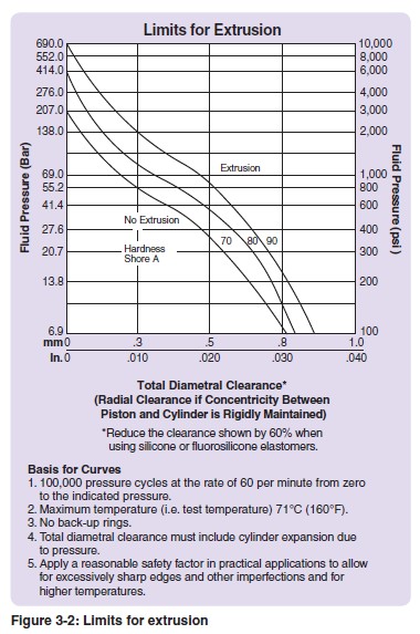

Here's a nice little chart from the Parker O-Ring Handbook:
Given Shore 75 elastomer, it seems to suggest that 0.010" clearance is a reasonable design limit for 1000 psi.

At 600 psi, Fig 3-2 suggests the clearance limit could be as much as 0.017" with a shore 75 ring.

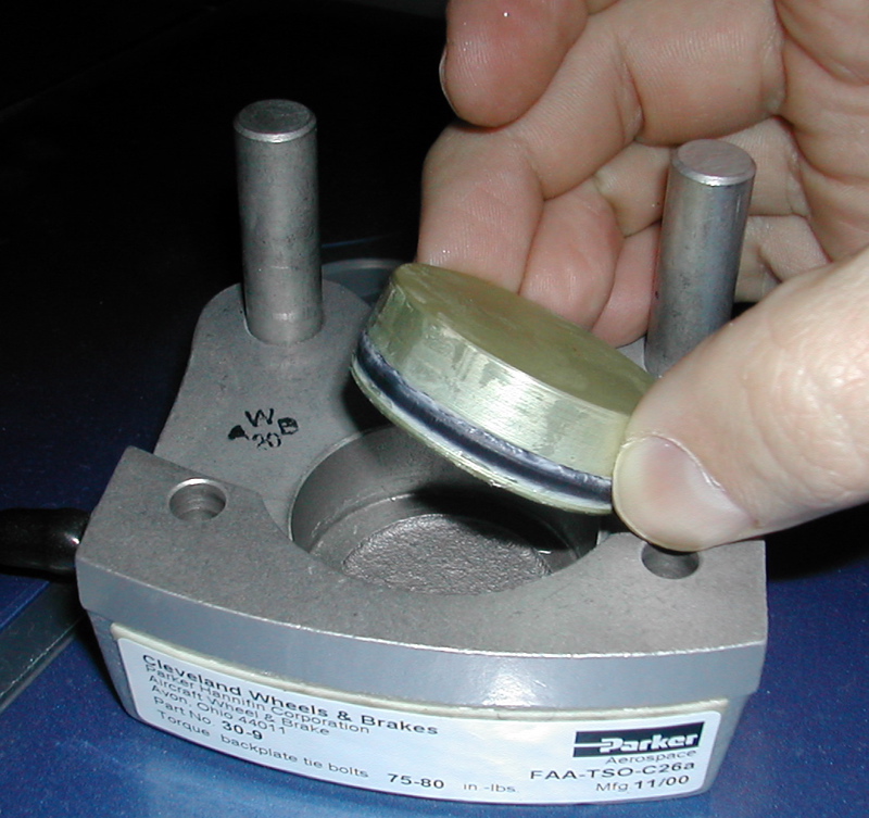

Has the o-ring lip peeled back (lifted) on your puck?
It will end up breaking as in this pic.

1) Heat
2) Pressures
3) And most important the o-ring lip at the land. The material is to thin. Notice the puck is distorted all the way around the land on the face of the puck... till it gives up. (the distortion cracks)
New pucks have a flat smooth surface.
One other thing I might add is that after about 5/8 wear in the pads, you will find the puck face does not stay parallel with the caliper housing. it will be cocked off to one side. This might just be causing the "peeling back" of the distorted landing face. If you look closely, the puck does not rotate in the caliper housing much if at all during the wear session of a set of brake pads.
1) Heat 2) Pressures 3) And most important the o-ring lip at the land. The material is to thin. Notice the puck is distorted all the way around the land on the face of the puck... till it gives up. (the distortion cracks)
None would strip the thin edge off the land, as there is no unbalanced pressure applied to it by brake application.

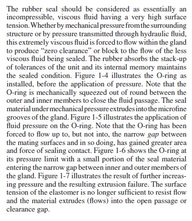

Consider the following, again from the Parker O-Ring Handbook:
They're all related, but no matter. None would strip the thin edge off the land, as there is no pressure applied to it by brake application.

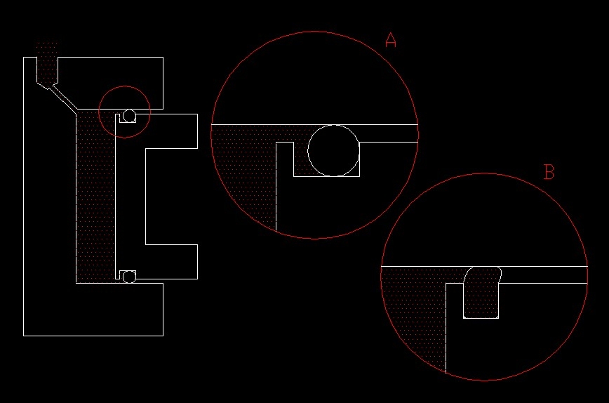

Consider the sketch.
(A) is an idealized representation. A high pressure area and a low pressure area are separated by the o-ring. High pressure forces the o-ring toward the low pressure, against the narrow annulus and away from the lip. Fluid pressure is the same on both sides of the aluminum lip.
(B) is a more refined representation. The o-ring fills the entire groove. The o-ring is still forced toward and into the low pressure annulus. The pressure within the o-ring itself (which the Parker Handbook describes as "an incompressible viscous fluid") is the same as the fluid pressure. Pressures on each side of the lip are functionally identical.
This is not a one time issue, it has been found on many RV's.
Perhaps you could quantify "many", after which we can look for the real cause.

At this point, in light of the graph Dan provided (thank you very much), I am inclined to think that at our low operating pressures , the issues are most probably baking of the o-ring or the brake puck was reversed. As I did not disassemble the offending brake, I cannot be certain how the puck was installed.

The GROOVE on the PUCK goes into the caliper first.
From Rosie: See this thread for more discussion.
Gary's photo...
...indeed shows the correct installation. Unless there is too much clearance between the piston and bore, it is unlikely that an o-ring will extrude at the system pressure we use until the brake lining material is pretty well used up. If the pistons are installed reversed, o-ring extrusion willoccur when the brake linings are approximately 50% worn.
