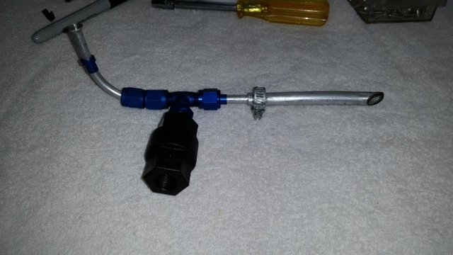

Here is a mod I did for the RV-10. Note:
- The piece out in the breeze is 3/8” tubing, cut on a bevel with a piece of aluminum screen JB welded across the bevel. This is for the mud dauber risk. The 3/8” tubing bevel cut provides more surface area for the JB Weld.
- The black nylon thing is a vacuum breaker suitable for fuel use. It only takes a few inches of vacuum to open the valve. Here if ice forms on the outside piece you suck in are from the wing root area. I never had a problem with fuel leaking past the valve.
The valve is very light and available from McMasters.

The webpage says these are check valves for oil and fuel. But here we're using it for air. Does that make a difference? I.e., it's spec'd to flow at .33 PSI fluid pressure, but what air pressure is required? Sorry, sounds like a dumb question.
Also when the check valve is open it's flowing air from inside the wing. I know the wing isn't airtight so it should work... but if this works then why not have the vent itself stay inside the wing? wouldn't it be less likely to freeze? Is it because we don't ever want back flow to splash fuel inside the wings?
There you go... a series of dumb questions... but I'm confused.

The valve opens on a slight vacuum (as in a breath).
You want a valve rated for fuel. If the tank is full and burps on a hot day, you want the vent to pass the fuel outside the plane, not into the wing root.

OK. Still not quite with you... sorry.
You didn't say taking vent air from inside the wing is bad. Assuming that's less likely to freeze then why not use it for vent air, rely on the valve as pictured to prevent fuel spill inside the wing, then have another valve reversed and venting fuel to the outside?
I.e., same picture as you already have, but another valve on your current vent flowing out only.
i think this is the gist of the interior vent
. . . then have another valve reversed and venting fuel to the outside?
The intent of the vacuum vent check valve is to allow the tank to vent from the inside of the wing (within the wing root fairing) if the exterior vent gets blocked by anything (e.g., ice, mud dauber, insect strike); that is - to relieve a vacuum inside the tank.
The check valve isn't intended to allow fuel to vent from the tank which it won't unless you pulled up behind a tanker for an in-flight top-off and the tank over filled. Then it would overflow via the outboard vent port.

The check check valve is supposed to be a safety device, providing an alternate vent in case the main vent is blocked. Your proposal turns the check valve into the only vent (since the second check valve now blocks the primary). Probably less safe as now a stuck check valve can cause fuel starvation.
