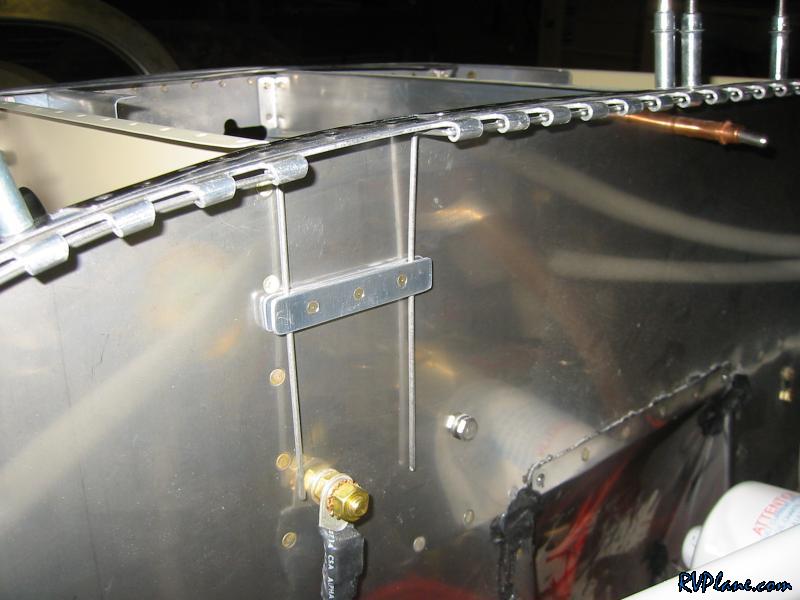

My take on a pin retainer (pin was trimmed after pic was taken). 800+ hours and no issues. Very low profile.
Mike Bullock
RV-7, Flying!
http://www.rvplane.com
EAA Technical Counselor
