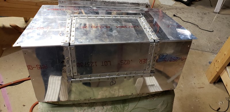

Question- I have seen various mods to access the aft mounted battery through
the baggage area. Has anybody cut an access door in the aft side skin. What
are the pros and cons? Structural- etc. Thanks for any help and opinions,

Methinks you need to get the factory to answer the question about cutting a hole in the side skin.

I got this from someone else on VAF - happy I made it. I would never consider cutting a hole in the skin.

Do not cut a hole in the side skin.
It would be all but useless anyway. You will remove the baggage compartment shelf and rear bulkhead at least once a year for a decent inspection. A quick access panel in the baggage shelf works fine for minor stuff.

Holes are light, there's nothing there. It's ensuring the hole retains the required structural strength that's heavy. Similar to how a fall never hurt anyone, the sudden stop at the end is what gets you.

:-) Same argument, couched a bit differently. I’m a wannabe engineer, at least my business card at the last place I worked said I was an engineer. Not bad for a guy with an HSG degree. But the real engineers I worked with all said holes are heavy, shorthand for just what David said.... keeping structural integrity around said holes adds weight. For example, a hole in a semimonocoque fuselage, big enough to access a battery, is going to add significant weight if it’s reinforced enough to maintain the same strength and stiffness. The door and it’s attaching hardware will be heavier than just a simple sheet of .025, too. The wording “Holes are heavy” is very elegant, no?

How often do you need to check the battery???
It's a dozen or so screws that hold the upper bagage floor and the rear bulkhead... 120 seconds to remove...

I added a hatch to the baggage floor and if building again, I would NOT spend the time and effort for this mod. For inspections and battery maintenance, I still have to remove the baggage floor. The hatch may be great to look in and see that everything is where is should be, but rather useless when it comes to maintenance issues. It took me about 15 hours to design and construct the hatch--wish I had skipped this mod.

ask someone maintaining an 8 about getting those screws out, and that big piece of bent aluminum around you and out while kneeling in the back cave. (without bending or scratching anything)
You'll put a quick access hatch in the second 8 you build....
