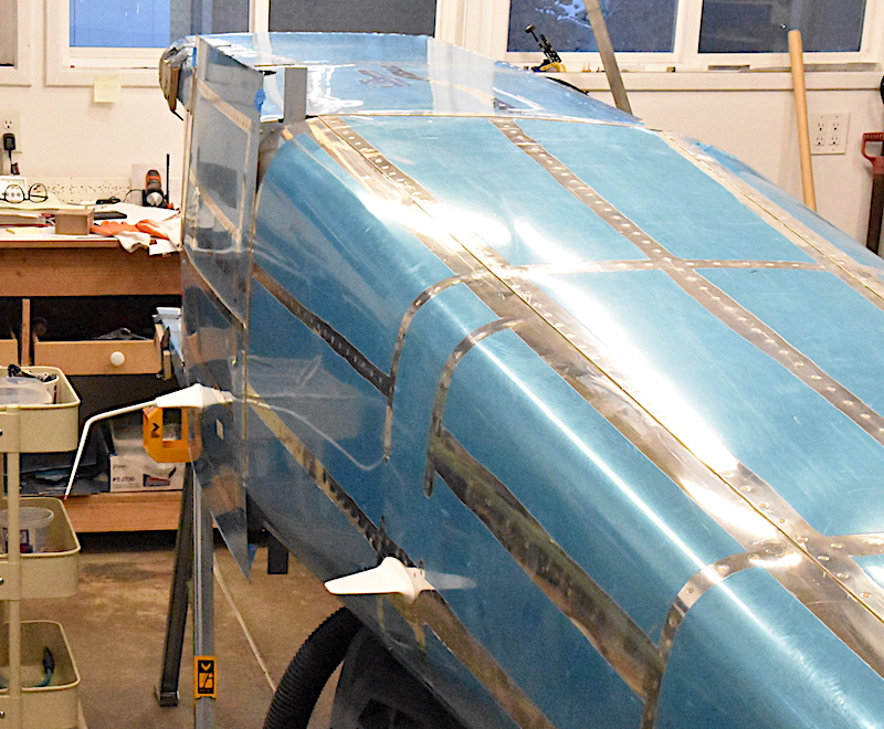

Nice job indeed.....but tell me, what's the benefit of riveting the L.E before mains skins ?
David Paule 12-19-2014 01:46 PM
With the main skins on, there's no access to rivet the leading edge skin to the spar flange. With the main skins off, I could get in there with a squeezer and these leading edge/spar flange rivets were easy.
In the photo, you can see the right leading edge assembly in place, to the left of the fuel tank ribs. The spar flange extends aft of the leading edge, and if the main skins were on, I couldn't buck those rivets.
The leading edge assembly is riveted while in a simple jig, after drilling the rivet holes between the skin and the ribs while jigged up on the wing. Then after riveting the ribs to the skin, the whole assembly is riveted to the spar.
Don't forget the spar web to rib flange rivets. They're kind of hidden away in there.

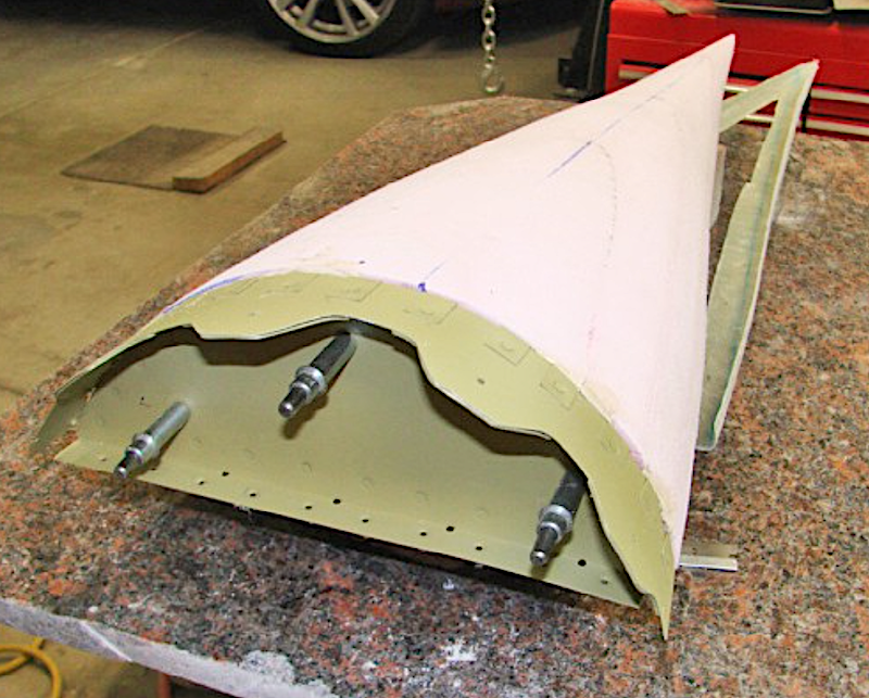

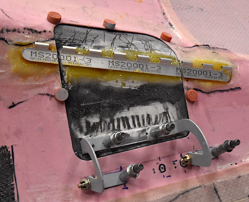

I was assembling the tanks to the wing before riveting on the tank baffles, just to be sure, and the left tank no longer fit on the outboard leading edge's splice strip. Remember that it was built in place on the wing, with the outboard leading edge attached. This time it didn't fit.
Turns out that the outboard tank rib interfered with the splice strip. Here's the rib and the skin. You can see how close the rib and the reinforcement piece are to the dimpled holes.
This shows the splice strip and how much it would need to be trimmed to fit - clearly a problem.
Later, I marked where I'd need to trim the splice strip and it was very close to those holes. I contacted Van's support and they recommended replacing the outboard tank rib and relocating the leading edge reinforcement plate to the inside of the tank. This didn't please me - I'm not that great at drilling out rivets. So I took a break to think about it.

That left the rib firmly sealed to the tank. Think glue. Here are the top rivet holes with no more rivets:
How to get the rib out? I bought a set of plastic picnic knives and they were of little use. The sealant was just too tough. I made a sealant knife by wrapping a piece of music wire around a couple of pieces of 1” dowel. I used several pieces of music wire: .015 was too weak. It cut well but broke easily. The .020 was the compromise that worked. The .032 was sturdy but cut poorly in the sealant at room temperature. Going across the dimples was especially difficult.
Then a friend suggested heat. I’ve got an 1,800 watt hair dryer and a few minutes with that let the .020 wire cut through the rest of the sealant. Using a piece of 1/2" plywood as a sort of wedge helped a lot, too, forcing the joint apart. I've got some serious respect for tank sealant now.

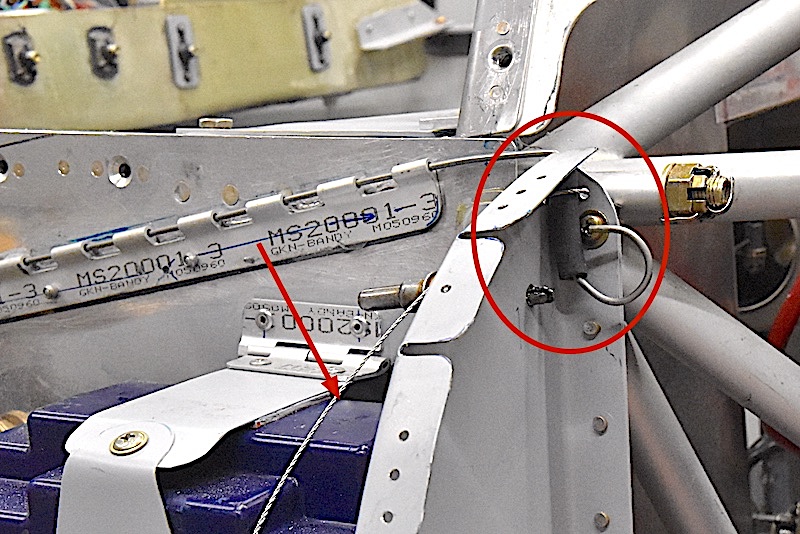

2. When putting safety wire through sheet aluminum (I've got a place where I'll safety the trim tab hinge rod by safety wiring the inboard end to a hole in the elevator), slip some plastic tube, like wire insulation or shrink tube, over the safety wire. Otherwise the aluminum might eventually crack.

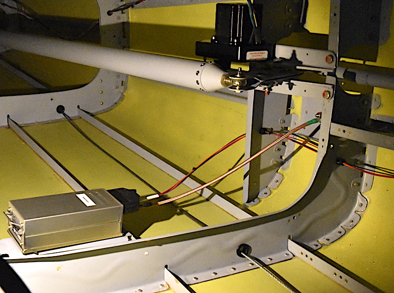

3. I've got a place where some wiring needs to exit a connector and immediately make a turn. There's no room for a plastic connector end - this is the roll autopilot servo in the right wing, with the servo close to the top skin. He said to use some blue sealant to protect them there.
