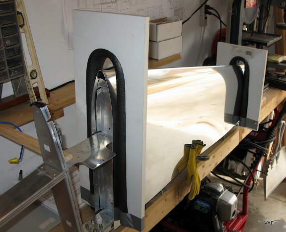

  HS skeleton riveted together, jigged, wood skin clamps made (old shelf).  Beginning drilling on HS skins.

HS-308 manufactured, angles bent and riveted to HS-302 front spars.
Tate holding HS front spar.
March 2009
HS-302 front HS spars cut/shaped.  Jig mounted on workbench for assembly of HS frame.  The idea (at least) is to build the HS, VS, Rudder and Elevators on a tiny workbench that I have running along the west wall of the two car garage.  My Miata fits in its normal spot after work sessions.  The wings are QB and will be stored at the hangar.  When it's time for the fuse I have an idea for building it on the side of the garage, after disassembling the workbench.  We'll see...

Drilled, primed ends and riveted on HS-306 end ribs to HS spar.  You mark and drill every hole in the -3B tail, so you use a rivet fan spacing tool to figure out where the rivets will be, then you can flute them between those marks without fear of messing up a rivet later.
