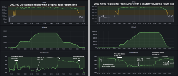

I recently removed a fuel return line on my RV-6A (carbureted). See https://vansairforce.net/threads/what-is-this-mystery-fuel-return-line-for.221249/. It accomplished the intended purpose of raising fuel pressures from the dangerously low level I had. Before, the pressures were 1-3 psi in flight (sometimes as low as 0.1 psi, triggering an alarm). After the design change, the pressure is 5-8 psi, and averages 6.8 psi in cruise. It still fluctuates, but at least it's at a safe pressure to keep the engine running.
However, now I have a carburetor leaking fuel. I already sent the carburetor in to Tempest Aero in NC. They normally test these to 6 psi, and at that pressure they could not replicate the problem. At 10 psi, they saw leaking from the float valve. They replaced the valve, and the carb is in-transit back to me now. But they were curious what engine-drivel fuel pump or fuel system plumbing I have that could be causing these unusually "high fuel pressures". They recommended I do not allow fuel pressures to go above 10 psi; otherwise the float valve could be lifted off the seat.
As far as I know, my removing that mystery line was just returning the fuel system to the stock Van's design. But their comment makes me wonder...
So, two questions, for anyone with a carbureted Lycoming O-320, with EIS data available:
  1. What is the typical fuel pressure you see in flight, and what is the highest fuel pressure you've ever seen?
  2. Is it normal for fuel pressure to fluctuate at all, in flight?
  3. Do you have any sort of pressure-relief valve in your fuel system that would prevent pressures from going higher than 10 psi?

And yes, it was a real fuel leak... On the ground, engine off, I turned on the boost pump and had a puddle of fuel on the hangar floor, dripping from the airbox. On takeoff I could smell fuel. Smell went away as soon as I turned off the boost pump.

I have an O320H2AD 160HP on my RV-4. Marvel Shebler MA4SPA carb, and have no mechanical pump. I run a Facet square cube boost pump as my full time pump, and have a second one as boost/back-up. With the standard old Vans fuel pressure guage (accuracy unknown) , I will get about 5 PSI static on one pump, 8ish with both. Engine running at idle, 4-5 psi on one. High power settings it will drop to about 1 PSI on one pump, goes up to 5 if I switch on boost. Cruise power settings are usually around 2-3 PSI on the guage. I have mistakenly left boost on after T/O climbout termination and ended up with carb overflow stains. These carbs do not like high pressure at all, and I don't like to let mine see over 5. It may be scary to see the pressure at 1-2 PSI, but I have never had so much as a stumble and its all it really needs.
If you have fuel leaking while sitting engine off and fuel pump on, the float valve seat is probably an issue. There is an old Marvel Shebler SB on that. IIRC it is a grounding situation.
That said, Lycoming Operators Manual states .5 to 8 PSI with desired at 3
Yes, they told me that possibly the concentric edge wasn't perfect. They swapped out the valve thingy with another one they had in the shop, and that one was fine up to 10 psi. It's just weird, because this carburetor is 65 flight hours since brand new from Aircraft Spruce. But I suppose it's possible the defect was always there, but due to the fuel return line the carb had never seen more than 3 PSI before in its life.
Hmm. I think for now I'll set the EFIS alert at Max 8 PSI, so I have margin below the unwritten 10 PSI max that Tempest told me on the phone. Fortunately, I didn't actually remove the fuel return line in my aircraft. I just cut it and installed a shutoff valve, so in flight I have the ability to relieve pressure if absolutely necessary.
So it's not just my aircraft with fluctuating fuel pressure depending on phases of flight? Why would that occur? I would expect fuel pressure to either never change, or change directly relative to RPM. But mine will fluctuate throughout the cruise with nothing else changing.
Fuel pressure shouldn’t be fluctuating. It will decrease sometimes with high power settings. The first thing I would do would be to hook up a direct reading fuel pressure gauge and see if it fluctuates in the air. Do you have a pulse dampening restrictor in the line to the sender?

When I say "fluctuating", this is what I mean. It's just a gentle change periodically, not pulsing.
I'm not sure actually, as I didn't build this aircraft. I would hope they followed those instructions when the sensor was added. The sensor is at the end of a long line, so it sits much higher than the fuel pump. The fire-shielded line screws into a silver-colored thing that could possibly be a restrictor.

I had an issue with carb flooding that I traced back to a faulty mechanical fuel pump that somehow failed to a higher pressure. I don't remember the exact pressures but they were way above spec. I did have the carb rebuilt as well simply because of age and to make sure no damage had been done to it, but a new pump fixed the issue, and was a pretty easy install thanks to VAF.
After a few hundred hours on a new fuel pump I started seeing inconsistent pressure in cruise flight. This was different from the often-reported low pressure indication during a climb due to sender difficulties in keeping up with changing ambient air pressure. After a couple of instances of rpm loss in flight I replaced the pump and steady cruise fuel pressure was restored.
By the way, I would plug the bypass port on your fuel pump fitting and ditch the entire return line system. It isn't needed in a properly functioning carbed aircraft and just adds additional failure points.

I wouldn't attempt a diagnosis or mod of the fuel pump, this is too critical a component for informal engineering. If a fuel pump is suspect it is prudent to replace it with a pump that has been officially blessed.
I flew a n O-320 powered 6A for nearly 1000 hrs. The fuel pressure was usually stable(ish) but did occasionally fluctuate down to almost , particularly in a climb or at a high (8k or so) cruise. The engine kept running smoothly all the time. This was with 2 different engine monitors, GRT and AFS. I removed the low pressure warning as it was serving no purpose. My conclusion was the engine wanted flow rather than pressure, indeed as you have found out too much pressure into a carb can be worse than no pressure. I think, but couldn't prove, the pressure senders were struggling at very low pressures. I could not find the reason for the lower than usual pressure, the boost pump always brought it up to 4 or 5 psi. As the engine kept running happily eventually I accepted the behaviour as a feature of the aircraft.

It doesn’t look like you have a restrictor fitting in the pressure line to the sensor.
But, Vic, isn't the purpose of the restrictor on the sensor line just to eliminate the quick pressure pulses? I don't disagree that it should exist, but how would affect long-term pressure reading throughout the flight?
