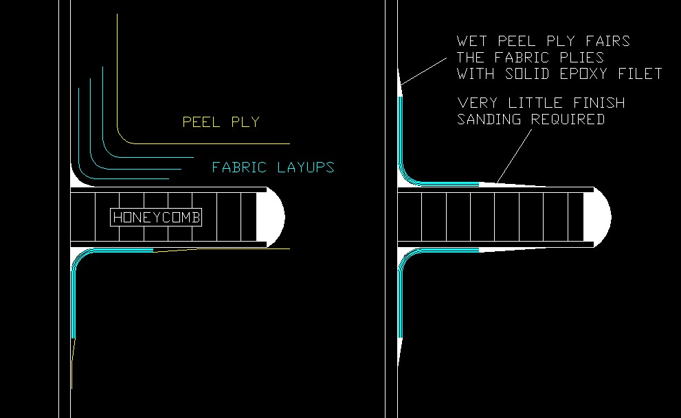

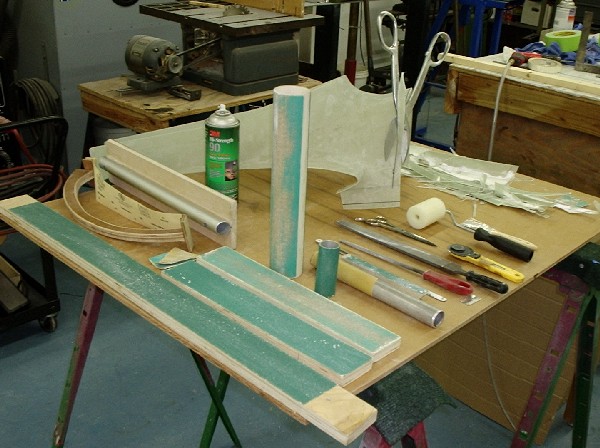

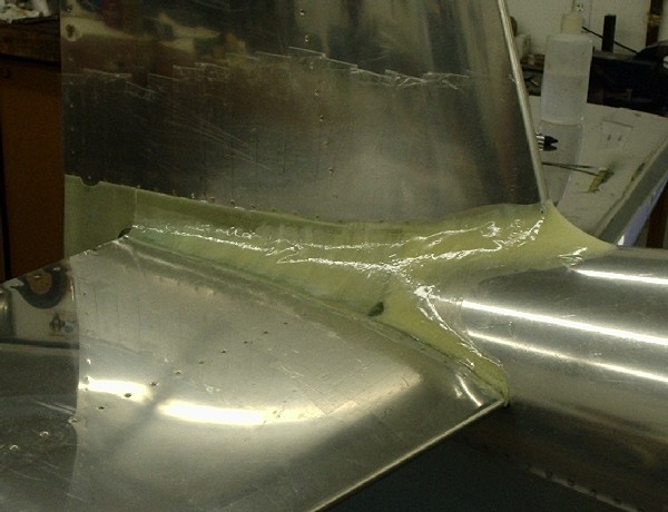

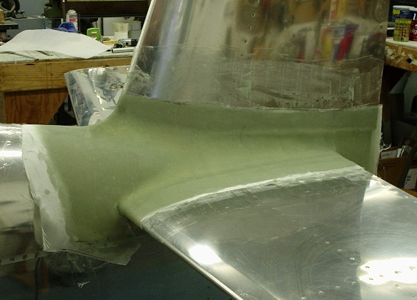

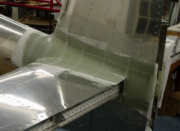

Tip: Fiberglass Fabrication
You can get dacron polyester fabric from just about any local fab store in various weights. When we were building the two Cozy MKIV's at my house, I would even find it on clearance once in a while in the Walmart fabric center for .99 cents a yard. If you use a fabric with a dyed pattern, it will sometimes bleed through though and leave the pattern on your fiberglass part!

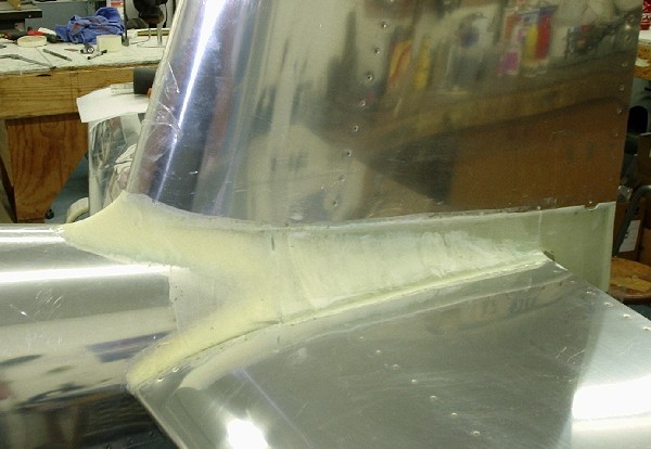

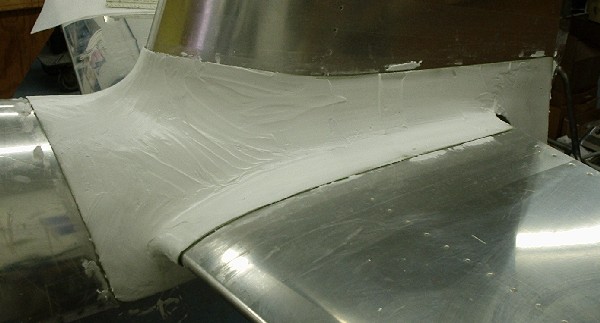

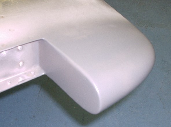

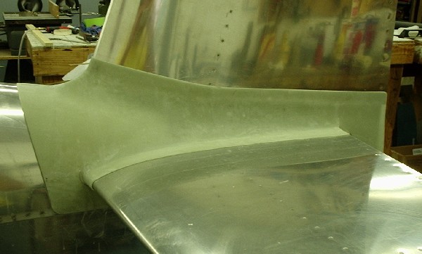

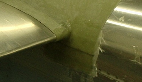

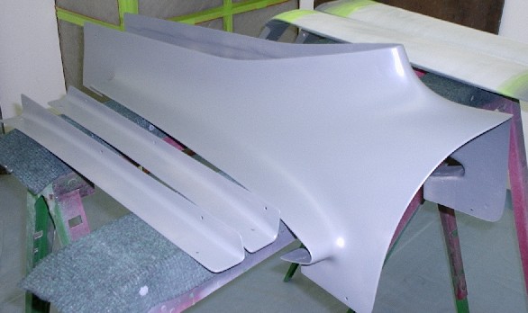

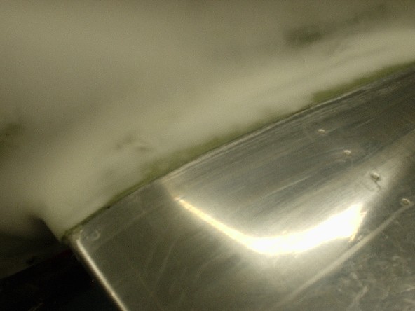

How many plies to glass empennage tips to aluminum?
For those who have glassed in their empennage tip fairings to get the seamless look, how many plies and what ply weight worked well? I like the look but want to minimize weight, and this isn't structural....but a single layer of very thin glass might crack over time due to vibration and different thermal expansion rates between the fiberglass tip fairing and adjacent aluminum surface. So I'm particularly interested to hear from those who have been flying for a while (what has -- or hasn't -- held up over time?).

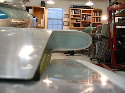

No fabric plies at all. Tips bonded with Hysol, riveted wet, gaps filled with micro. Still doing fine at 875 hours.
Wow, that's amazing...I'm really surprised that you haven't seen any hairline cracks show up where the micro meets the edge of the aluminum skin!
So I'm told. It's an experiment, and may explode any minute.
So, more than a decade ago, why did I think it would work? Here's reality. The tips are cheap polyester glass. The coefficient of thermal expansion is about 14 microinches per inch per degree F. The coefficient for aluminum is typically around 13. There is no significant thermal expansion difference to drive cracking, thus I assumed cracking was merely a function of poor component fixation.
The polyester glass is inside the aluminum flange, and evenly bonded (i.e. evenly stressed), not fastened at individual points. I could have drilled out the pop rivets after the Hysol cured.
Check back in another 800 hours. I'll keep the crow in the freezer.

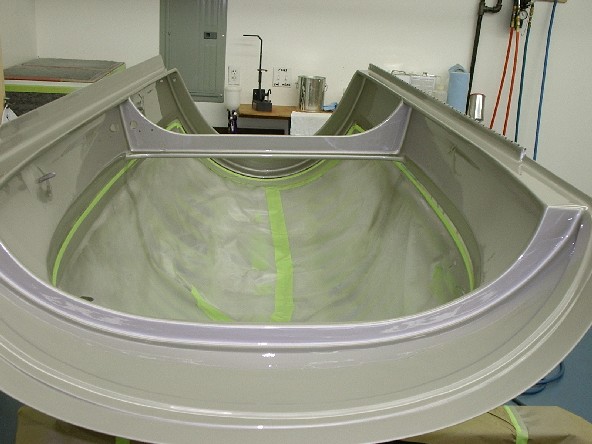

The standard canopy is not tall enough for me, and it's ugly as sin.
I decided to convert to an open cockpit sportster, a fun flying adjunct to the RV-8. At the regular 08A Sunday sunset meeting, one of the group sort of dared me to build it all in lightweight carbon, which was actually sensible, unlike most of our beer meeting ideas. The current plan will make both sections removable with just a few fasteners, quickly exposing the entire interior of the fuselage for inspection and maintenance.
Really stiff parts at lowest weight require that the top and bottom fiber elements be moved apart with a core element. Here I went with 1/8" honeycomb, similar to a Vans cowl. The best matrix application (the epoxy) would be to use pre-preg, but I was far too lazy to build the necessary oven, pre-preg is expensive, and cheap foam forms can't be baked anyway. The game was to see what I could do with a typical home shop wet layup, vacuum bagged.
First thing was to make two foam forms. They required a nice surface finish, in particular the turtledeck, because I want to leave the inside carbon pattern exposed. For whatever reason, folks just love the look.
Methods are just like the smaller parts in previous posts...shape foam, seal it, give it a smooth finish, wax, PVA, and do the layups.
Clean up, then lay out and cut all the materials.
Now for the fun part. Very rapidly, drape the first ply of 5.7 oz twill on the form, wet it out, then drape the honeycomb. Wet out the top ply of twill between plastic sheet to keep epoxy ratio reasonable, peel one side of the plastic, and drape it over the honeycomb. Add a perforated release ply, and a bleeder ply, then slide the whole thing into a big bag (furniture storage bags are huge), seal it, and apply vacuum.
The raw turtledeck shell, untrimmed, weighs a bit over two pounds. It would be a little lighter if made from prepreg, as there is some excess epoxy with the wet layup. However, the wetness means the interior finish is attractive with no other work. It is very stiff, and not being structural, more than strong enough to mount on the airplane with no interior ribs. It's just a big fairing. I will put a headrest bulkhead in the cockpit end.
The cockpit cover was made in a similar fashion, but with more carbon (5.7 twill and 12oz plain weave on the inside, 12 oz plain and a top sheet of 9 oz glass on the outside). It must support the windshield, and stand up to abuse when the pilot gets in and out.
Plenty more detail work to do, but here are the basic shells. I have two windshields, one the forward end of a broken RV-4 bubble, and this one, the aft end of an RV-8 bubble I found in the shop attic. I have not decided between them yet, but it should be a cute airplane either way. More later.

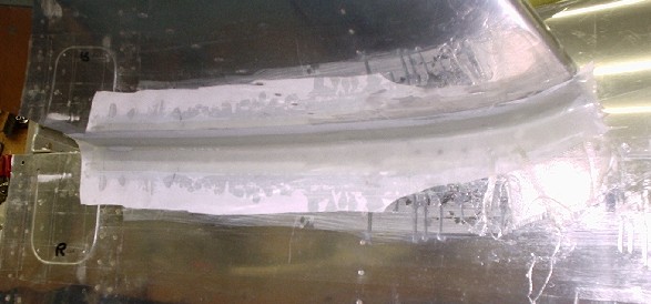

Did you just fill the gap between tip and aluminum, or fill the pulled rivet heads as well?
Trying to decide how to attach / finish the empennage tips.
Thomas

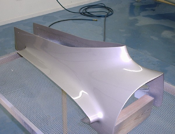

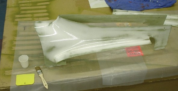

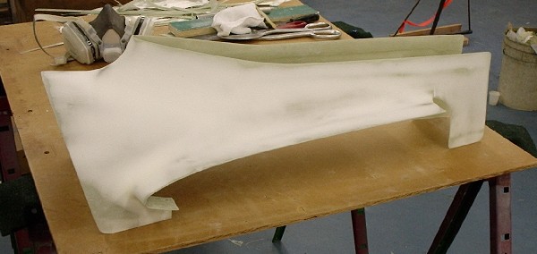

Airbox replacement for a Bower can with broken reed petals, on an RV-8. The usual pink foam form, epoxy sealed, waxed, PVA, do the layups. Variation here is doing the whole job on the lathe....shaping the foam, the layups, sanding, the works. Just set a spidle in the foam with wet micro, and use it to spin the form.
Not an optimum solution, but it should keep the rocks out for now.
Roughing with a hand saw:
Shaped, epoxy skin, sanded, waxed, ready the spray PVA:
After cure, the shelled foam peels out of the 4 ply layup like a bad sunburn:
Tried a new trick. The layup got an epoxy wipe followed by sanding, then it was sprayed with an epoxy primer; the first shot of primer lets you see any remaining imperfections. Surface was good enough for this engine component, but there were a half dozen random pinholes on the outside and a few hundred on the inside. Gave it a wipe, inside and out, with Akzo Nobel 28C1, the one shot pinhole filler, Seemed to work just fine on the primered surfaces. Me like, because it's real fast compared to chasing them out of a sealed surface with a two-part putty. The inner, non-sealed surface was a straightforward use for the 28C1; scrub on, let dry, scrub off the excess leaving the filler in the pinholes.
You might ask, why not just use the 28C1 on the outside right from the start? Well, it does nothing to hide weave or improve surface contour. The epoxy shell does both.
