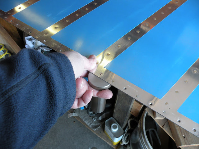

I've had the SB 14-01-31 repair kit for a couple of years now, and thought I'd get it installed before attaching the horizontal stabilizer to the fuselage. The number of enlarged holes in the spars, ribs, and angles (some of which date back to the original construction) has been bugging me, so I sent an email to Vans. Sterling concurred, so I am replacing the front spars, attach and reinforcement angles, inboard ribs, and new pre-drilled doublers.
I ordered parts Monday, and they are due Saturday. Yesterday I started drilling out the front spars. 3-1/2 hours into it, I have the left front spar removed, and am about 2/3 the way through the right.
Enlarged holes in the attach and reinforcement angles:
Left front spar removed:

Hey Miles.....I did the same thing. I started doing the SB and got some elongated holes. So I ended up drilling skins and replacing anything that
was needed.....got a great HS and confidence that all is in great shape. Not worrying about those egg shaped holes in the back while I will be flying in the front:) Replaced both front spars and one reinforcement...the other one came out real nice and could be reused.

Another 30 minutes in the shop Friday, and I had the right front spar out of the horizontal stabilizer, completing the first "R" in this R&R project. That blinding light in the upper left of the photo below is sunshine streaming through an open hangar door, something we've seen precious little of around here this year...
