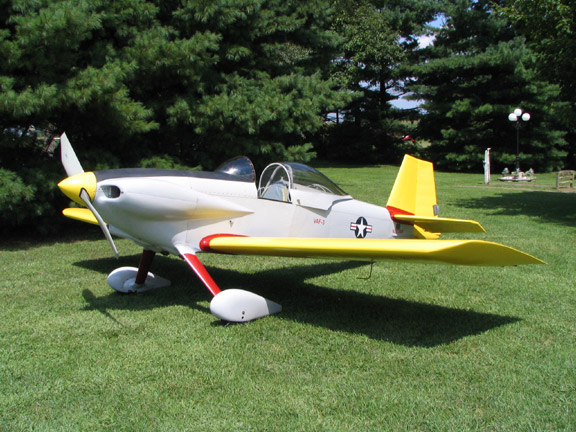

I have been a painter in autobody shops, and aircraft refinishing shops i have painted show winning cars bikes planes boats musical equipment, everything besides a train.. (hmmm a train with a flame job....). I now own a custom aircraft paint shop, and i still do bikes, drag cars, classics, hydro boats etc.. I have painted several RV and Experimental airplanes.. not to mention lots of certified aircraft and war birds.

Man i would love to do this all night, but i have to paint an RV7 right now... If any of this helps please let me know, and if you have any ideas or thoughts id love to hear them.
